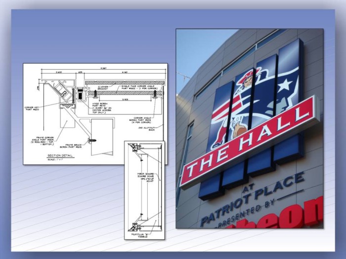

spectrum maine
THE INTERNAL BRACING IS PART OF THE SYSTEM
