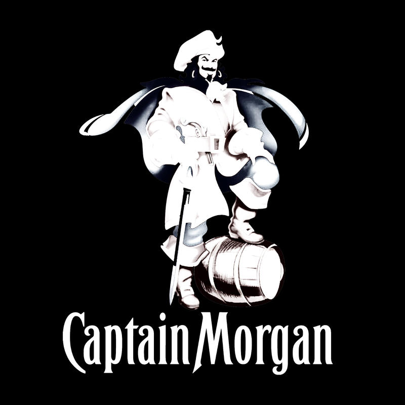

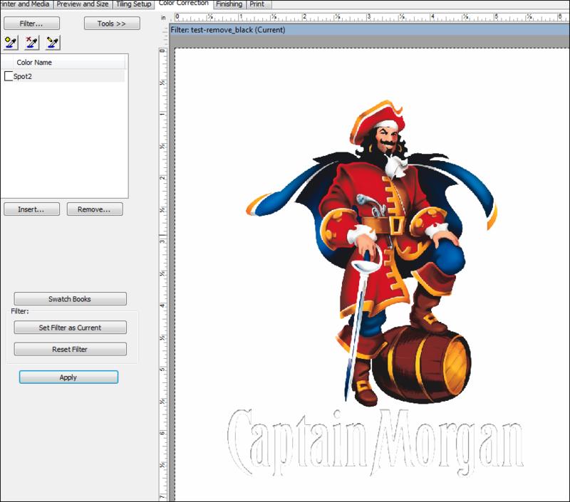

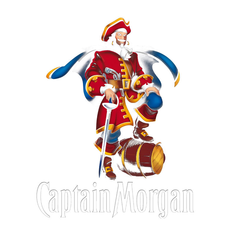

I have an application where I need to print the background of an image 3x but the logo itself only once. I'm able isolate the black background to print only the logo but I need the exact opposite. I need to print only the black and leave the rest empty. Is there a way to invert the selection using the spot mask or spot replacement tool? This will be a recurring application so tracing the outline of the logo isn't a viable option.

Yeah, it's in Job Editor. The Color Correction tab, then Tools >> Spot Layer Tool.
Once there check the little Enable Spot Layer Generation box, and you can actually do quite a few things with whatever your spots are, right there.

We'll have to just manually do it in photoshop like the attached pictures. I was just hoping Onyx would let me inverse the Spot replacement tool. Oh well no biggie!
