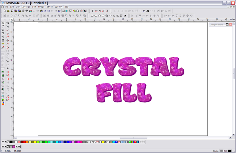

hello guys.
i have flexi 7.5 v2 and lxi expert 8.6
is there any way i can create rhine stone pattern using theese softwares.
i want to fill the test letters with small circles
or which is the best way to go.
thanks in advance

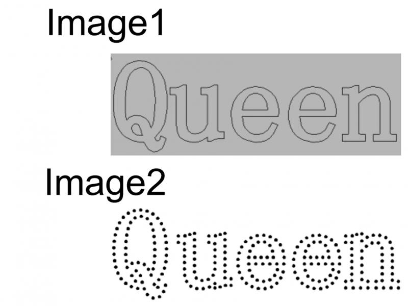

hello fred
Thanks for the quick reply.
I am looking for something that will convert the outlines of images and text into small circles ( as small as 2 mm in some cases).
please see the image attached below. i want to convert image 1 (or text file) to image 2.
how can i do this in flexi or lxi?
or which software has this option that support vinyl express qe 60.
Thanks for your time..

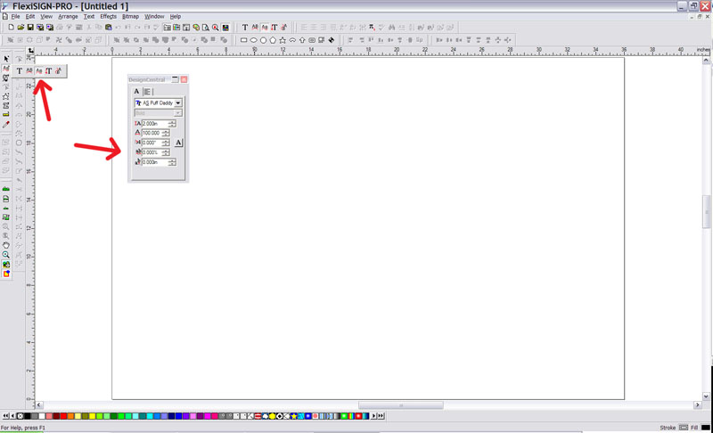

Hold down the text entry tool button to see and select other text entry tools including the text on path tool. You will find excellent instructions on its use in the Flexi help file built into the program.
You will be able to control whether the path is the baseline, mid point or height line of the text as well as be able to vary the spacing by using the control in Design Central.
