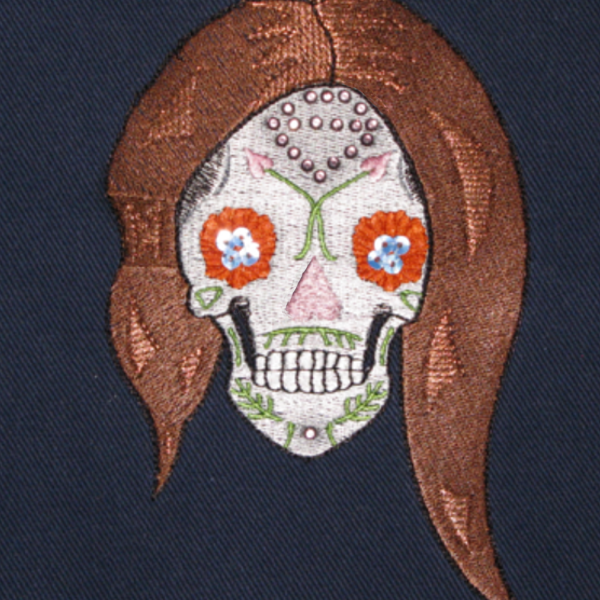

My suggestion would be to use stones as accents instead of a whole design. In other words, I might do embroidery, sequins, and stones, instead of a design all of one thing.

What about doing a design with Spangles?
Spangles (aka sequins) have the same size concerns, rather they are heat applied or embroidered on (what I do) have different limitations in designing.
Most common size for here is 5mm, so designing has even more limitations. Now, my machine can handle 4 sizes, only one smaller then 5 though (3mm). But, because around here the common one is 5mm, there are more color selections compared to the other sizes with sequins.

Spangles, minus the hole and thread come in 3 sizes, 2, 3, & 4 mm.
The have the same size concerns (as in what you have to worry about when designing), not necessarily the same size.
The sizes that I had listed where for embroidered sequins, not heat applied

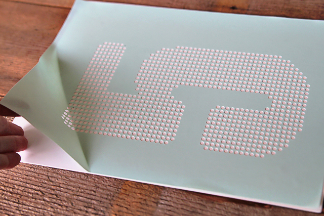

The rhinestones I've used are heat applied. There are different sizes as well. I have the silhouette cameo + silhouette studio designer edition. In here you can create rhinestones templates. Its the drawing with the wholes (like the picture I attached) then you fill it up with the rinestones and put them on the heat press.
Not a big deal, but not my thing neither. I did not look up where you located but theres this website (novarhinestone.com) that is located in cali and houston where you can buy them and they can help you out figuring out what you really need.

If you don't have a program that either has rhinestone module or a plugin, something that automates the process (I would imagine that the silhouette program would automate it, so no worries there in that program) and you are designing exclusively in Ai/DRAW/Inkscape etc, you have to compensate for things like overcutting, prevent overlaps etc yourself. Doable, just a pain.
If you outsource the template creation, probably no issues there, let them deal with it. However, trying to at least check it out quickly before sending it off might help spot some things before it gets to them.

Yes, the silhouette studio does it automatically and of course would be a pain to get it done manually.
But is just for him to see what options he has.
Most of the time is not even worth the effort and the time just for one piece.
Its easier to outsource it and get it done by someone that already knows what they are doing :)
