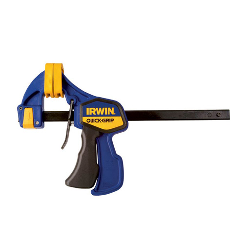

I simply used some Quick Clamps to hold the mat in place and ran a router with a flush trim bit all the way around the table, worked perfect especially since my production table has rounded corners on one end.
This is also my method of cutting down large sheets of polycarbonate for sign faces.
Oh and the mess, that's what a shop vac is for.
