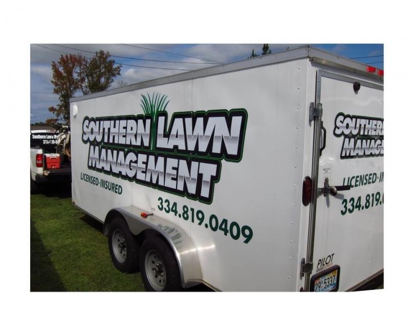

visual800
The trailer below have all bare screws removed and put back in. DO NOTallow your clients to talk you into wrapping or painting screws, you cannot yell and its a waste of time, this is not brain surgery folks
