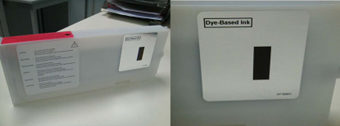

The printer does not have smartcards on the cartridges. Just optical recognition by label (mirror and black squares). You can made them very easy.

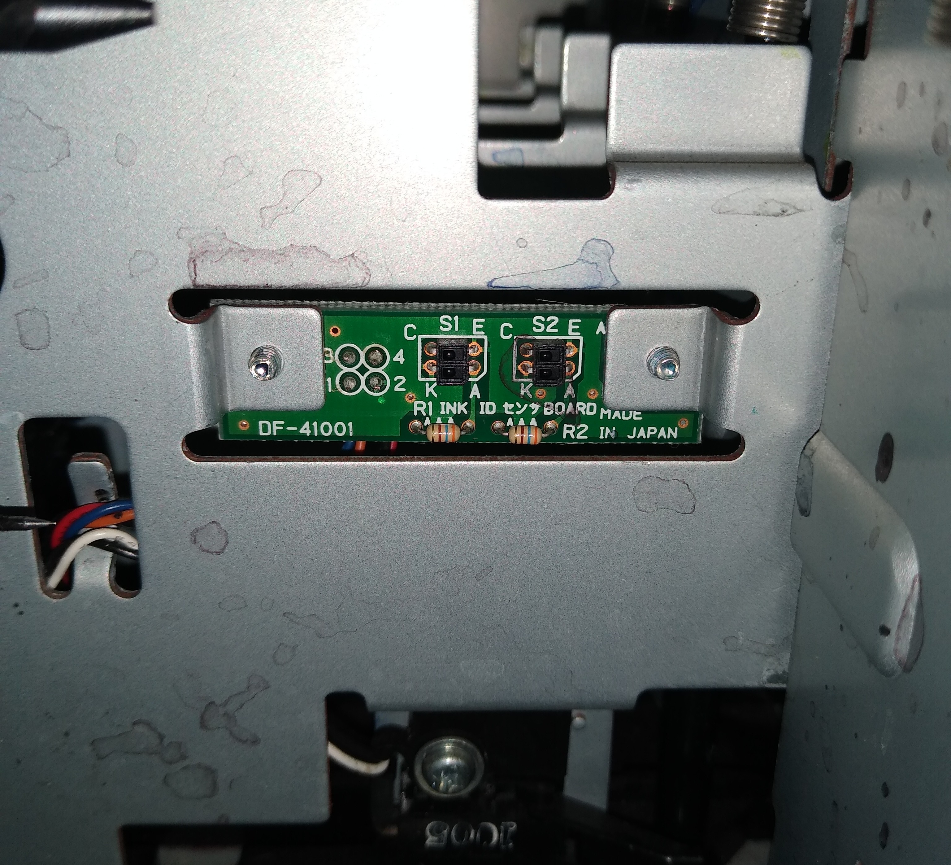

So after doing a bunch of testing I found that the sensors in question only check ink levels. They do not inform the machine of the cartridge presence or ID. The RJ900c seems to rely on just some tiny white switches where the front of the cartridge loads and not any kind of cart ID system. I was able to tape down the switches in question and proceed to cleaning and maintenance cycles.
sporgo
Picture of the suspected ink level sensors. Varying the level of light that reaches these influences the printer reporting low ink levels.

No. It is ink ID board exactly.
The sticker on cartridge looks like mirror self-adhesive vinyl about 5x5 cm with black squares about 1x1 cm. The sensor detect reflection difference depends on square location and the printer accepts the cartridge.
Low ink sensor located under ink ID board.

That seems to be a reflective sticker with a window in the sticker to monitor ink level.
It's much simpler than that. The ink ID board is simply looking for that black box on the mirror sticker to verify it's a Mutoh cartridge. The ink level indicator is that little plastic tab that sticks out of the whole in the cartridge.
sporgo
Ok that is in line with what the guys on the electronics board thought. One side is looking for the reflection off the label and the other for no reflection thus the blacked out square. I would suspect they alternate the pattern for different carts but maybe not.
Either way my particular unit does not seem to be bothered by the lack of them. Its possible the previous owners had that turned off maybe to convert it to dye sub inks.
