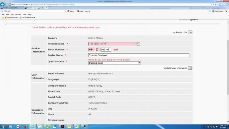

Of course this happened on a Friday trying to get another RJ900C set up for a large project with a tight deadline.
We made a critical error when in a hurry and entered the wrong serial number. With that said we did receive an activation code but for the wrong serial number
Product Name: RJ-900XA
Serial Number: HB4A002196
Activation Code: 0D1110CC000014DC
The actual serial number is HB4A002195
When we go back and try to register the correct number we get a "null" error file attached. We even tried registering as a new customer but still get the same "null" error. Just hoping against hope someone has an idea or we will be forced to wait till Monday.

You have the serial number typed in wrong in the picture. It looks like you have HB40002195, charge it to HB4A002195 and it should work.
