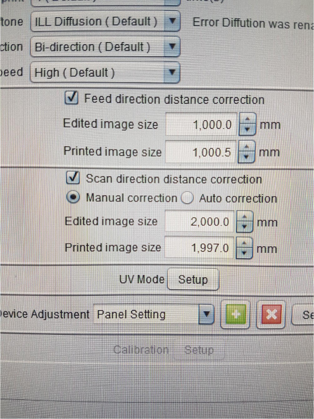

Does anyone have experience using the scan distance correction under the "quality" tab in Rasterlink 6? We have a JFX200 that doesn't quite print to full scale in the scan direction, but is dead on in the feed direction. For an example: a 48"x96" file prints at 48"x95.8". It's proportionally less the smaller print is.

1. Print the desired file size. (recommend a large file)
2. Measure the actual print.
3. Enter the values in the correction box. (The desired output and the actual output)
4. Print again.
Let the values stay in the box and it should work out everytime, regardless of print size.
I printed a filled rectangle 2000x1000mm, measured and entered the values.
