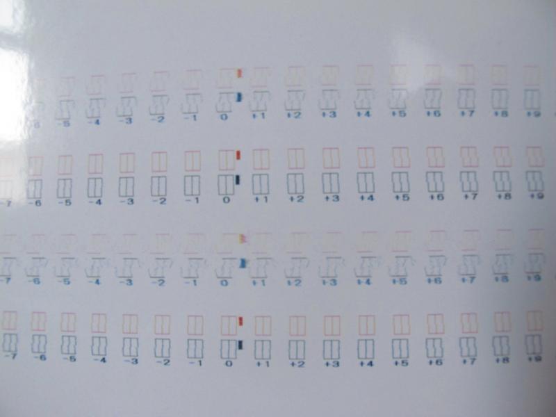

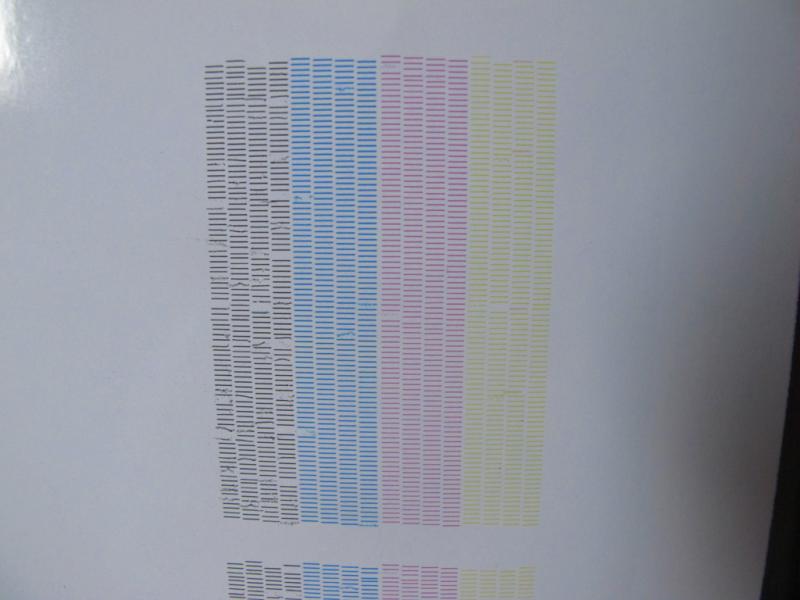

here are 2 test prints, i have all the colors printing now but just real sloppy

If head soak won't solve this, a new print head is required. In the capping position, try to pull with a syringe through the cap-top coresponding to group A(Cyan_Black). Just take out the tube coresponding to the cap-top from group A, from the junction with the pump tube, put a syringe there and pull gently couple of times. If this is not working, then you'll need a new print-head for sure.
Robert M
Print head
I think Gabriel may be right on that head, it looks more like deflection on an old head then a clog. What is the shot count on that head, the manufacturer says they are good for around 6 billion fires. If you need a tech manual shot me an email
