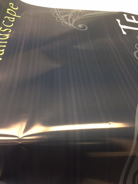

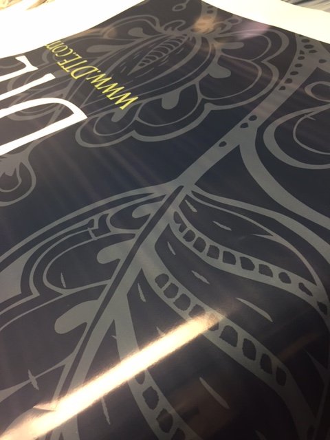

Need Help Roland 540 Banding issues!!
lexsigns
Have had 2 techs here 3 times- changed dampers - It really only does on dark solid colors.. There are huge 1/2" bands and its almost a pattern- We cleaned the grid wheel and also the strip that runs along ( forget what its called) did calibration, cleanings, everything under the sun
Have tried tons of settings etc- last time this happened i used 2 other printers at my suppliers and they did the same thing too. Its really annoying and frustrating! They keep saying its probably the heads but its only 2.5 yrs old...
Any help or advise would be greatly appreciated!

I've gotten these too. We were seeing it when there was a communication error between the printer and computer. We would also see when we didn't pre-roll the media and it would "pull" on it. Have you tried changing out your ethernet cable?
lexsigns
cable-?? no I haven't but I will see if I have a different one to try- Ill also try freeing up the tension on the media.. fingers crossed I am desperate!

Tried taking tension off and helped the bands are further apart but still there- could it be a heat issue?

check the ink cartridges sometimes the rubber nip gets pushed back and the needle does not puncture the seal it looks like ink starvation.

Update! So an amazing member here ( I dont know your handle to personally thank you) who happens to be local reached out and contacted me- He said he knew what my problem could be, STATIC!
Over night delivery for stopstatic.com kit ( who are also extremely helpful)
and my printer is working just great again. I cant use my supply 55 take up or it creates more static and messes it up but its working and I am saved!!
I cant say thank you enough for helping me out! Sign people are the best!!!
Next question is what to buy for a take up reel, do I spend for the Roland one that goes with it ? What are you guys using and do they create static problems?

They keep saying its probably the heads but its only 2.5 yrs old... [/QUOTE said:
Maybe they are right. Printhead life is counted by shots not by years. It is shown in the service mode, any channel reached to 6 billion shots (million x thousand) the head won't work properly (DX7). It can be in less than an year or maybe 5-6 years depending on how you use. Heavy cleaning shortens the head life significantly. In average 2 years. Or premature wear caused by some 3rd party ink.
If you have static issue then more likely your floor is carpeted. If so you can't get rid of the static problem.
Regarding take up reel, you could buy chinese one from sign in china at $200-$300. I use it all the time even for my new L315.
