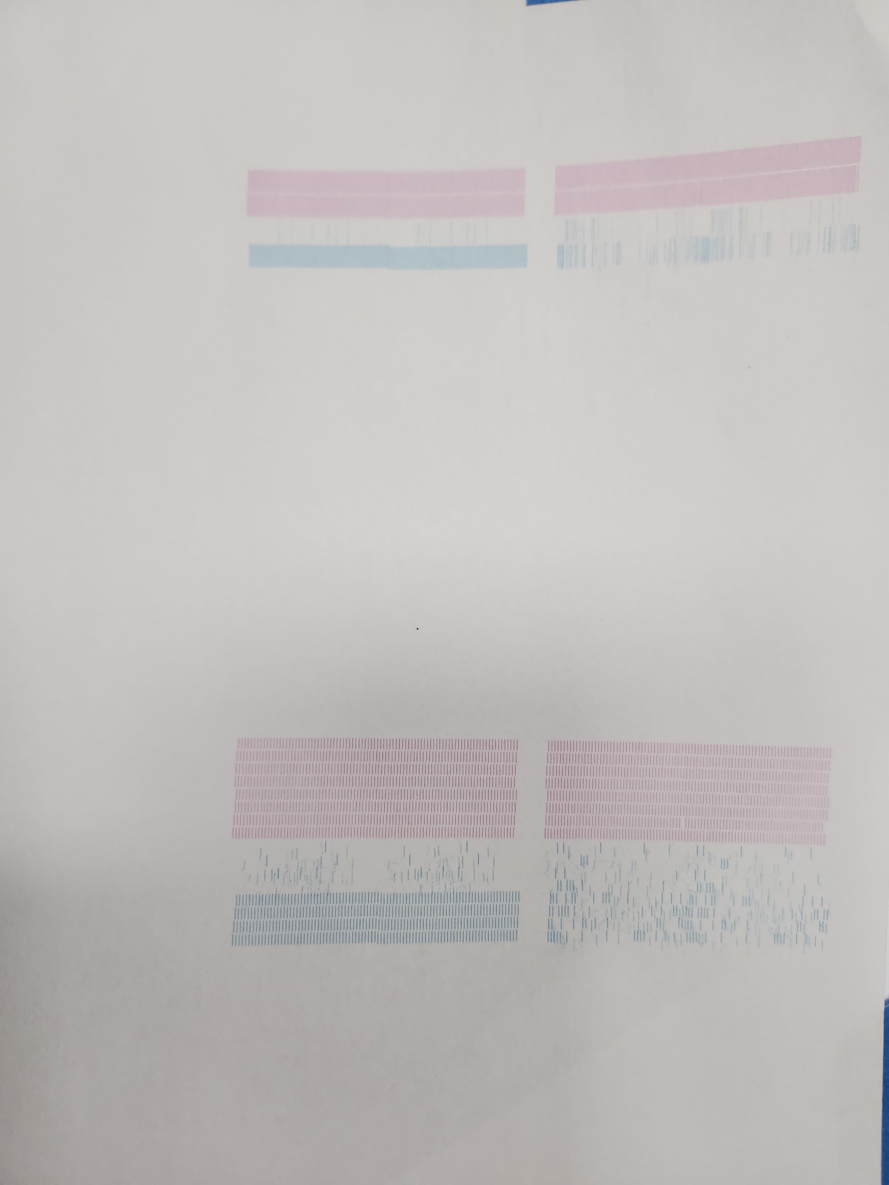

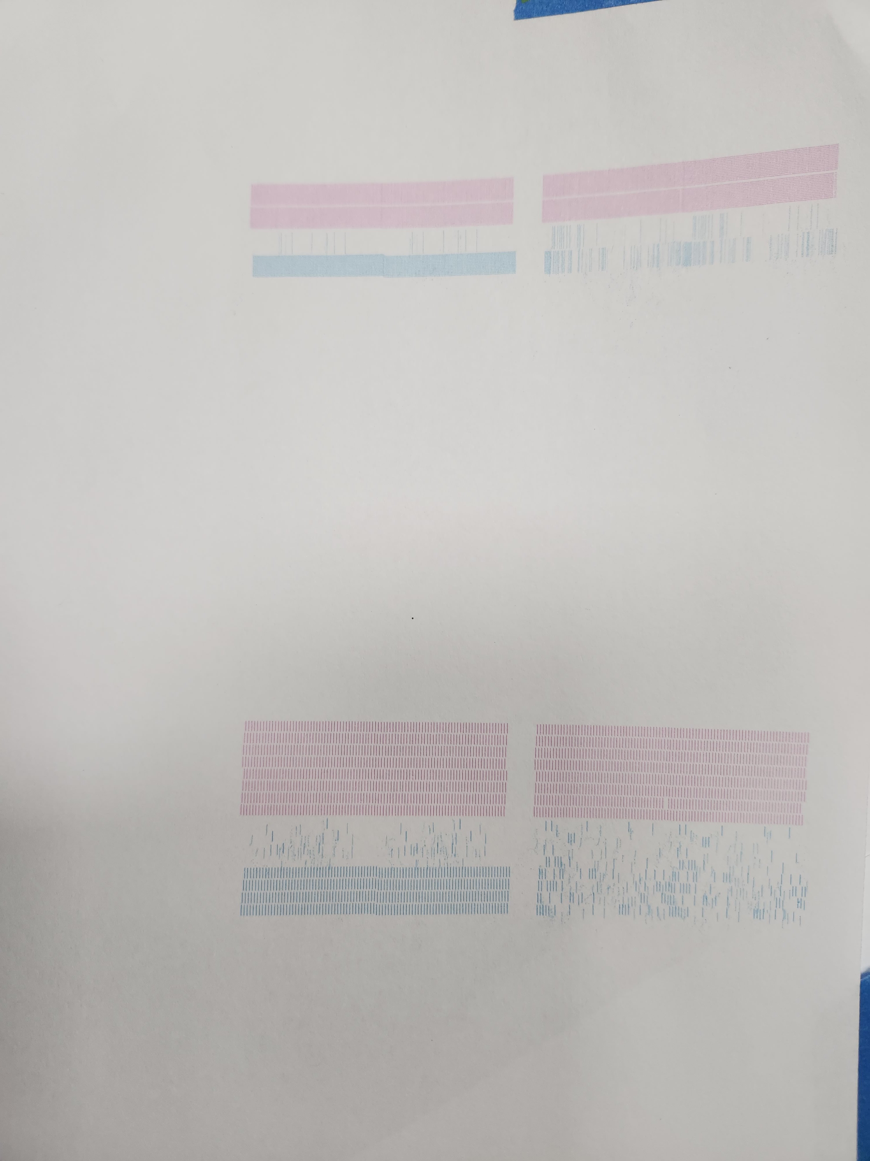

I have a Roland 640ft and I started having blurry prints. The cyan and black nozzles were off so I tried replacing the dampers and printheads for those colors. When I did a test print afterwards, only one side of the cyan and black nozzles were there. I've done cleanings and syringed the ink through and now every color is gone except magenta. Ink is coming through when I syringe all the lines so I'm not sure what I am doing wrong?

The test prints haven't been okay they don't show ink except the magenta even after pulling

Here is what the test print shows

when you pull the ink up to the dampener and its filled ok, are the ink lines staying full or are you getting air pockets in the line?
also when you put the new heads is did you enter the new head codes into the printer?
also have you tried auto fill, as if you are commissioning all the heads for the 1st time
IndySignPro
I had this issue after replacing a head and dampers. It took me performing 10-15 powerful cleanings to pull and fill the dampers and purge all of the air.
