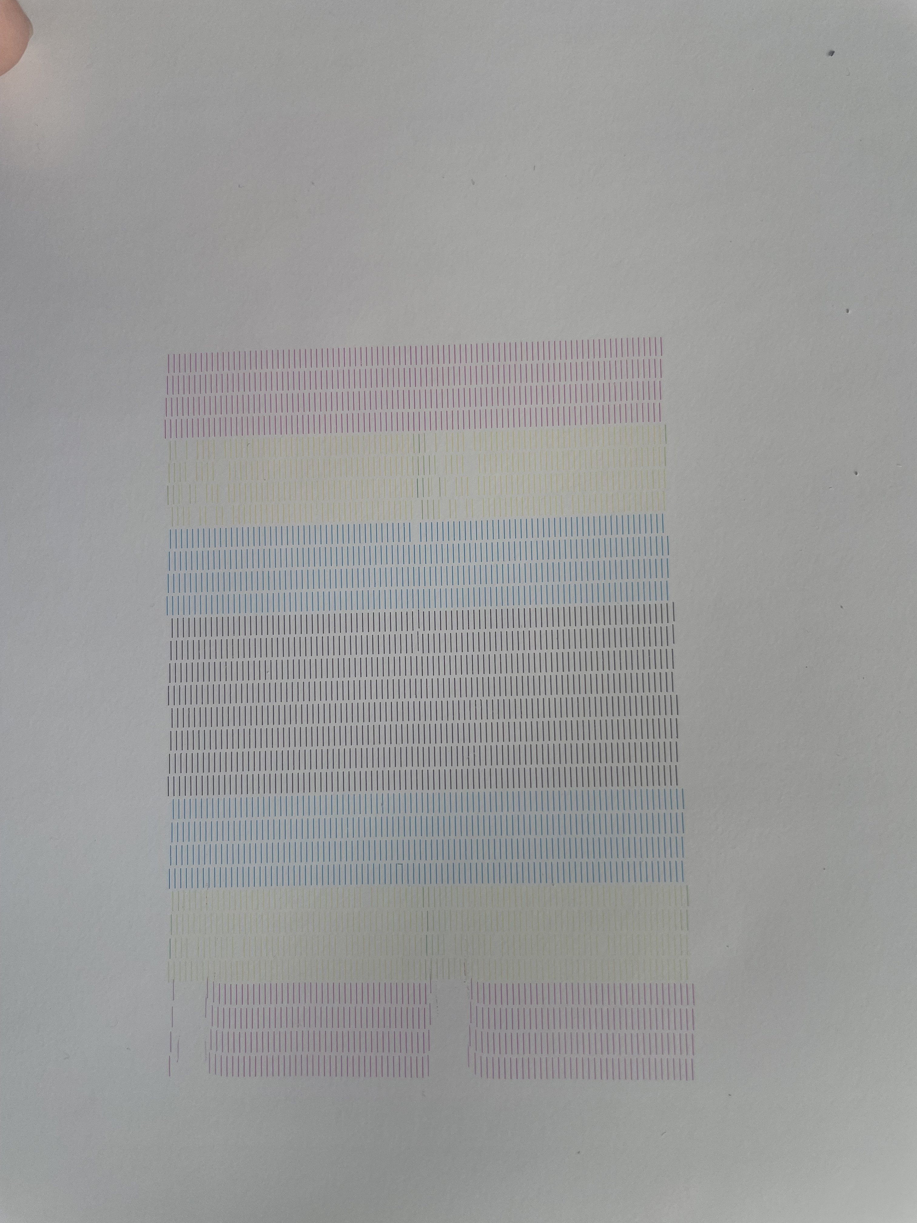

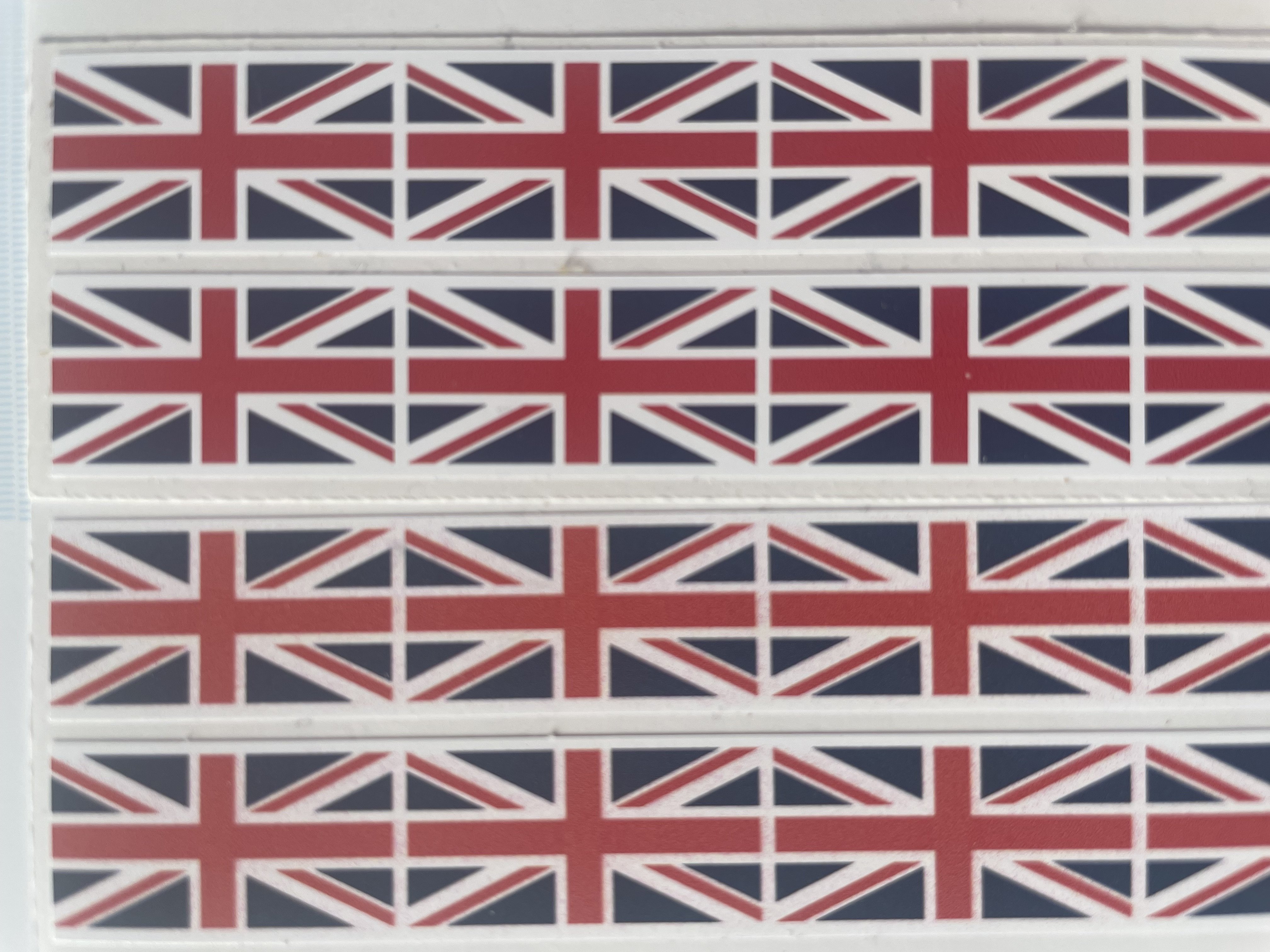

Thanks for the reply Jim. I've attached two photos, one of the test print. This shows the Magenta drop out although after a clean this will go or move around. There's also a photo of how it was printing approx 3 weeks ago, top of image and today bottom of image. It looks more of an orangey red, also a bit of magenta haze because because the magenta level is turned up with the yellow to +5 to try and get a better red.

Thank you for sending that. There is some damage to the magenta, looks like you had a head strike, it certainly explains the magenta overspray. Someone else might have a different suggestion, but based on what you show, a new head is in order. If you got 6 years out of this first one, that's pretty decent.
