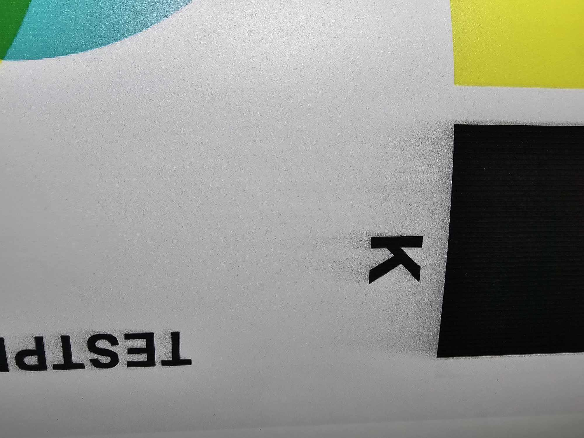

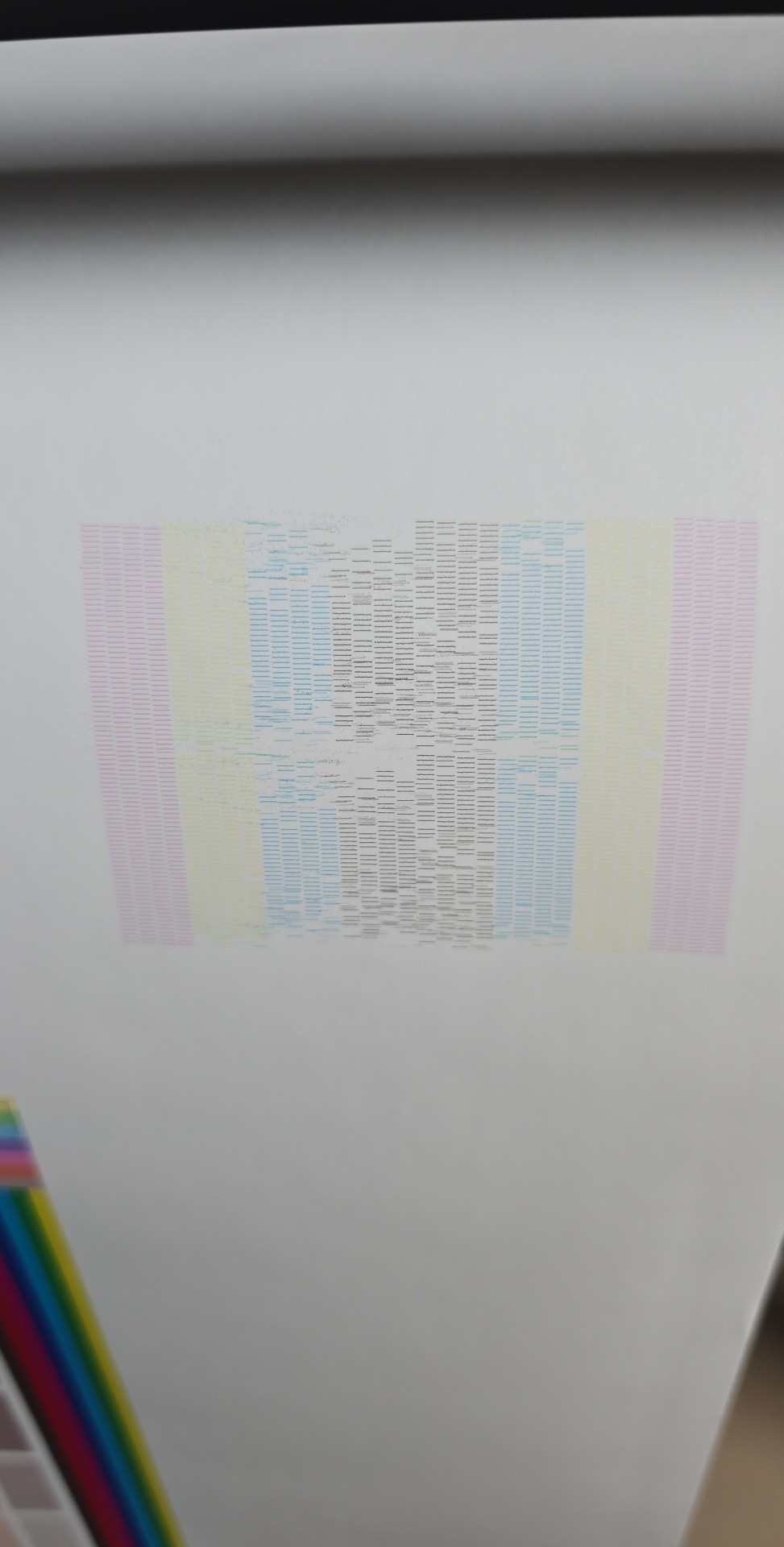

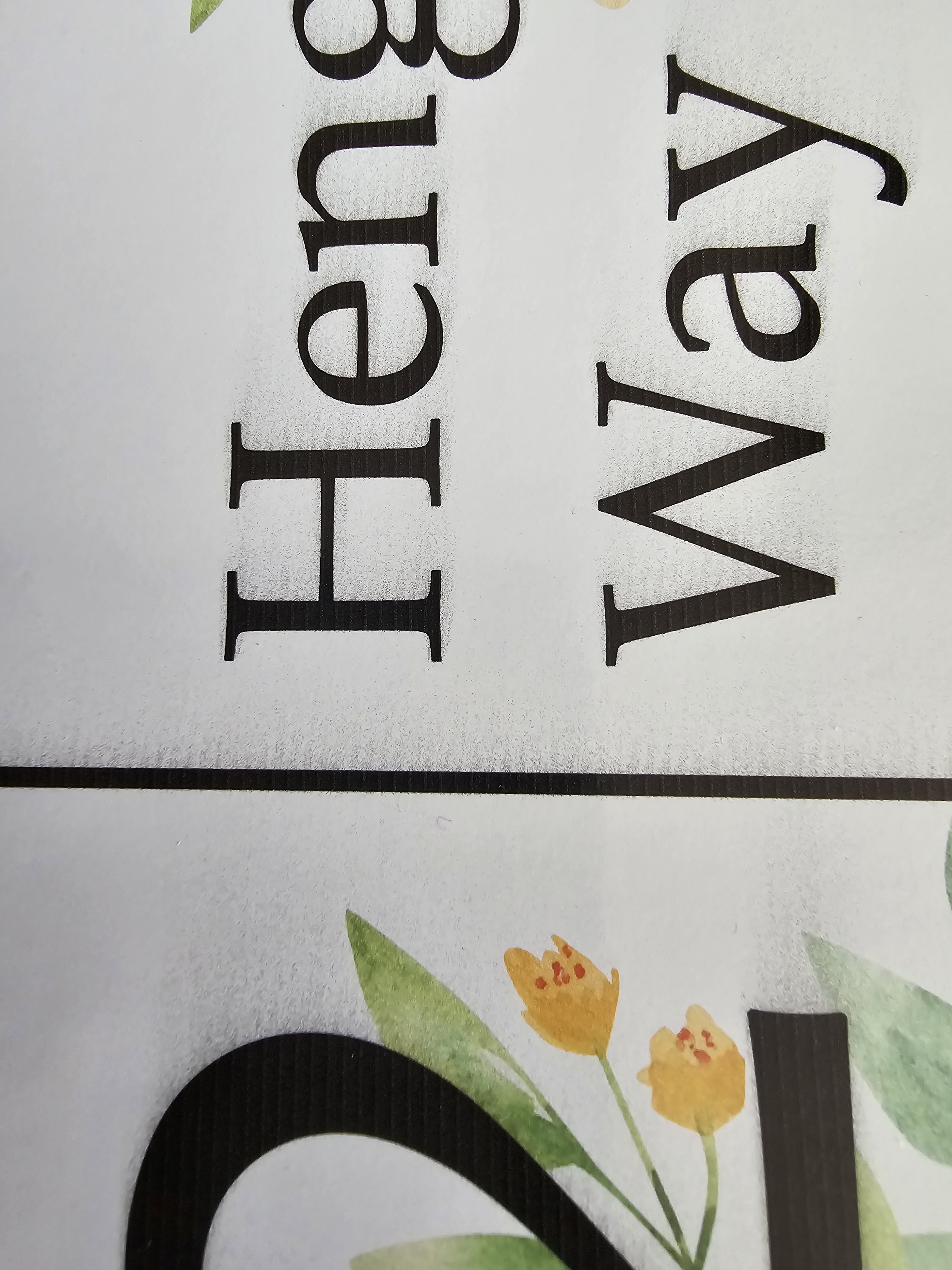

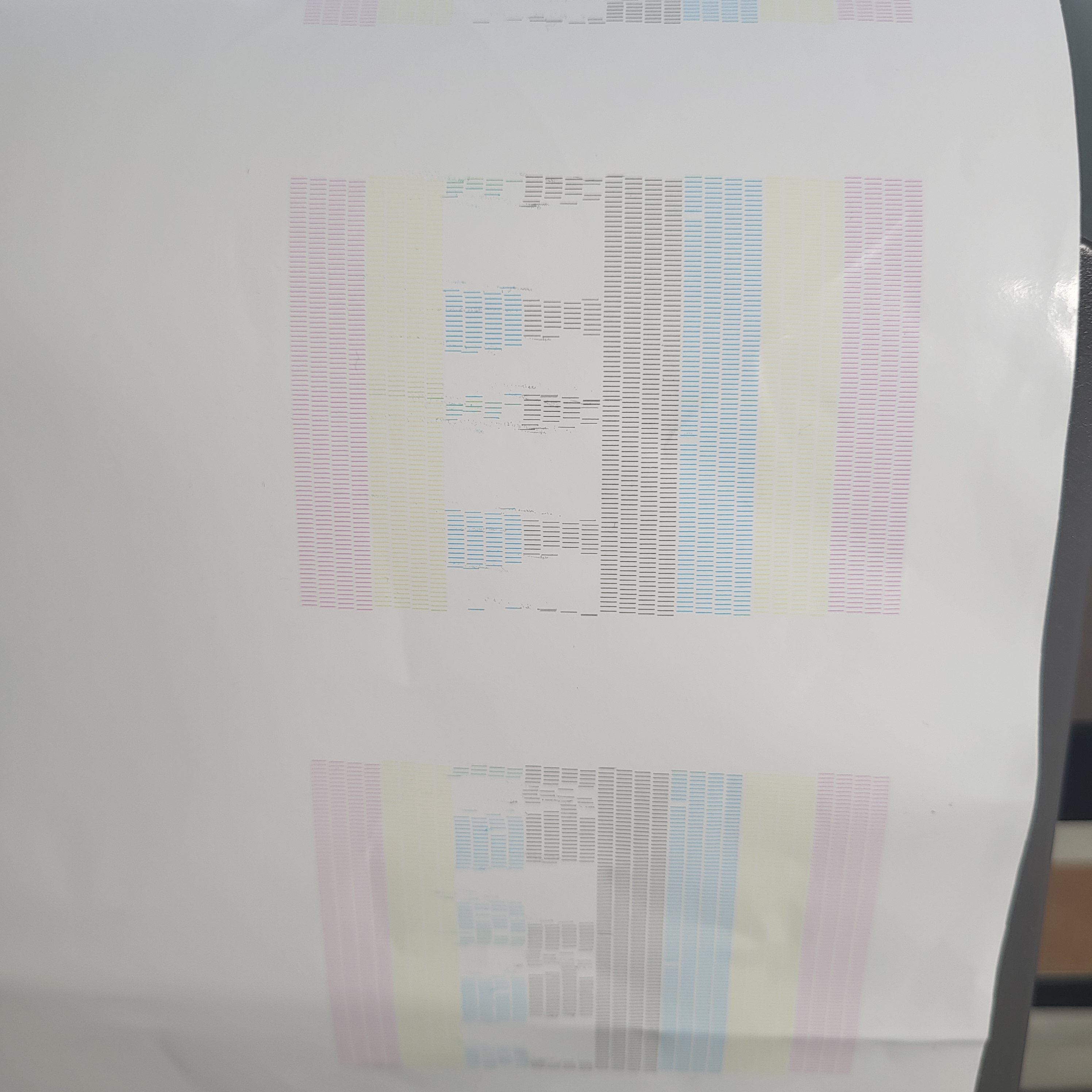

Hi I have recently had an issue with my Roland BN-20, Prior to the manual clean the nozzle check was fine, a couple of missing lines but all printing was superb no issues at all, After the manual clean, I did a nozzle check and it came out as shown in the photo, So then I did a couple of medium cleans which improved the nozzle check prints a lot to the other image below, But since this, Every time I try to print something there is a black overspray and banding. This is my first solvent printer and I am trying to figure out how to resolve this issue, A new head is out of the question for me since the printer cost me 1k and 1.5k plus other fees is just not feasible for me at this time. I have tried number cleaning, Soaking the capping station in solution with the head parked in it over night. Any suggestions would be very much appreciated for this newbie trying to learn!
I know im asking a lot but if you have any suggestions could you please add a brief explanation of how I would go about doing this, or point me in the direction to a video guide etc.
Thank you in advance for your replies!

How did you clean the head manually in the first place? From the nozzle tests it looks like you have damaged it. First step would be to change the captops and see if that improves the test prints
Hinchy
I just did what it said on the utility, I didnt clean the head directly, and I read putting a bit of solution in the capping top which I did also, Thats all i did, Thank you for your reply.

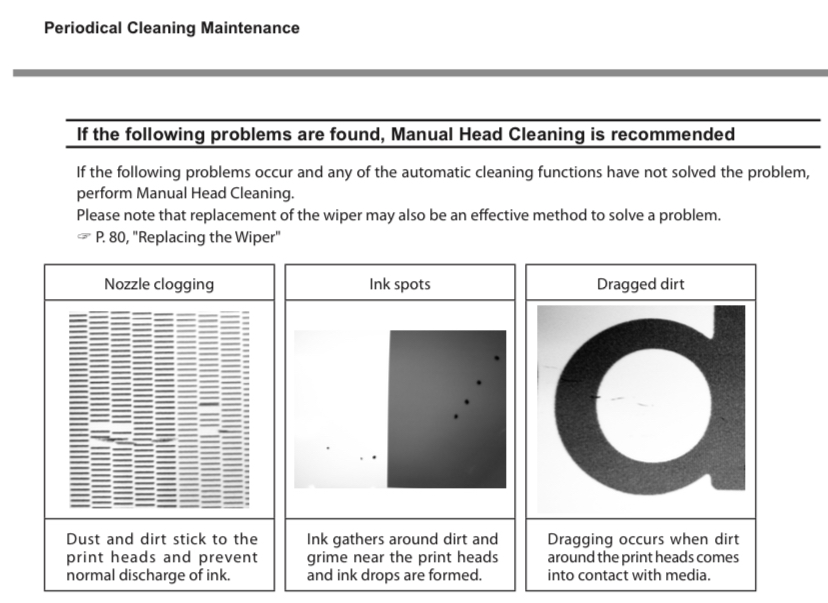

STEP 6: Maintenance after Daily Operations( ECO-SOL MAX 3)
In order to maintain stable printing at all times, Manual Head Cleaning is required after daily operations when using ECO-SOL MAX 3 ink.
You do not have to perform this cleaning after daily operations when using ECO-SOL MAX 2 ink or ECO-SOL MAX ink, but we recommend that you do so periodically once per month.
 P. 77 ,"Manual Head Cleaning"

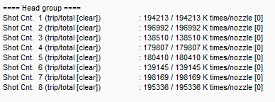

1715604371410.png 1715604428704.png I found this information on the printer, I am guessing the head should of been ok since it doesnt look like its printed all that much and the nozzles fired are under the usual amount before replacement?

I'd start with changing the cap top, as it sounds like you're in the process of doing. If you think there is a clog in the line you can try pushing some cleaning liquid from the line after the cap top to see if it goes through and comes out into the waste container. If it goes through no problem and you're still having some issues after the cap top replacement, might be worth while to replace the pump. The overspray is typically caused by deflection, either by build up blocking a nozzles or from damage. If none of these help, you might be looking at needing a new head, but hopefully that won't be the case.

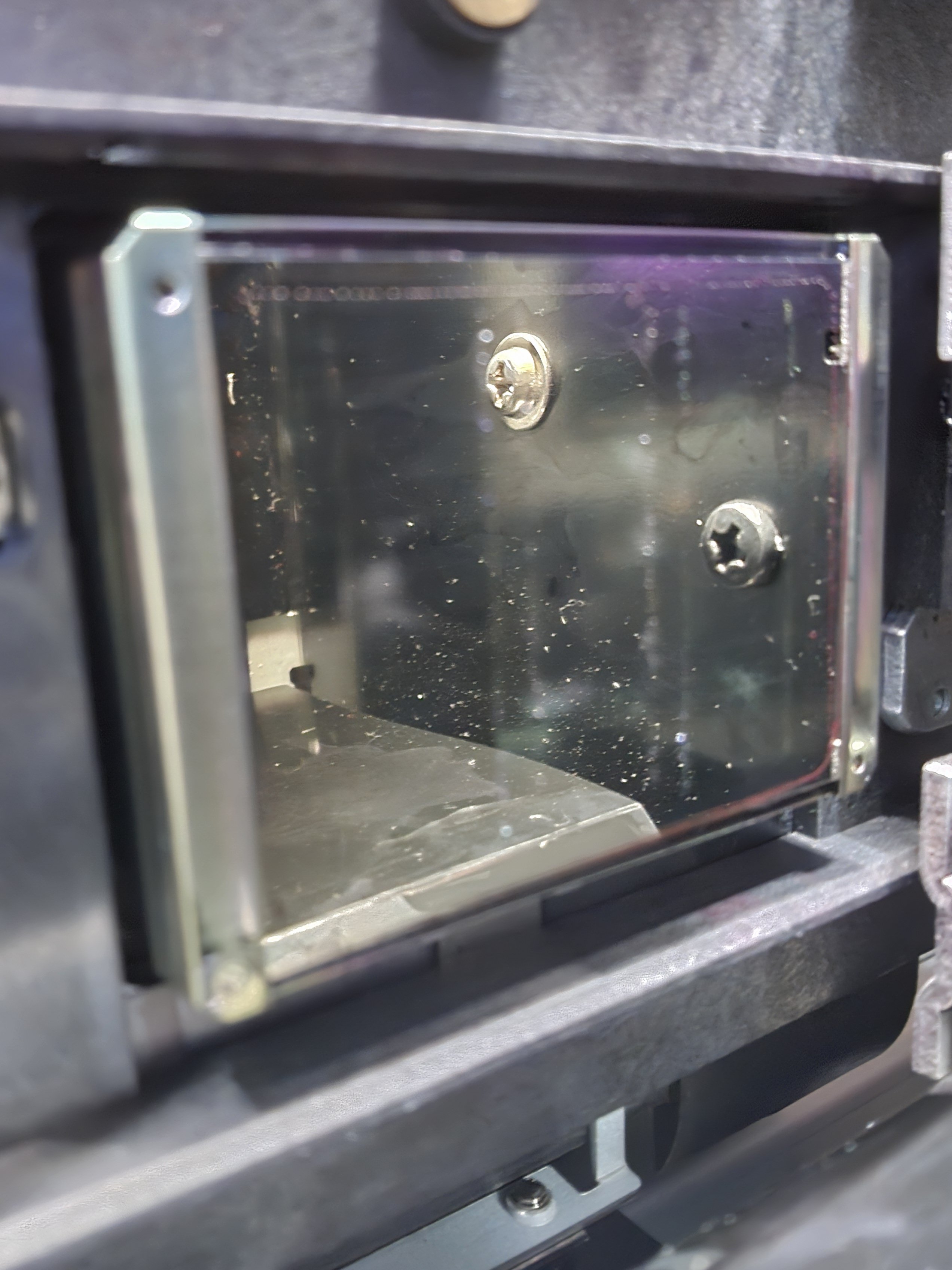

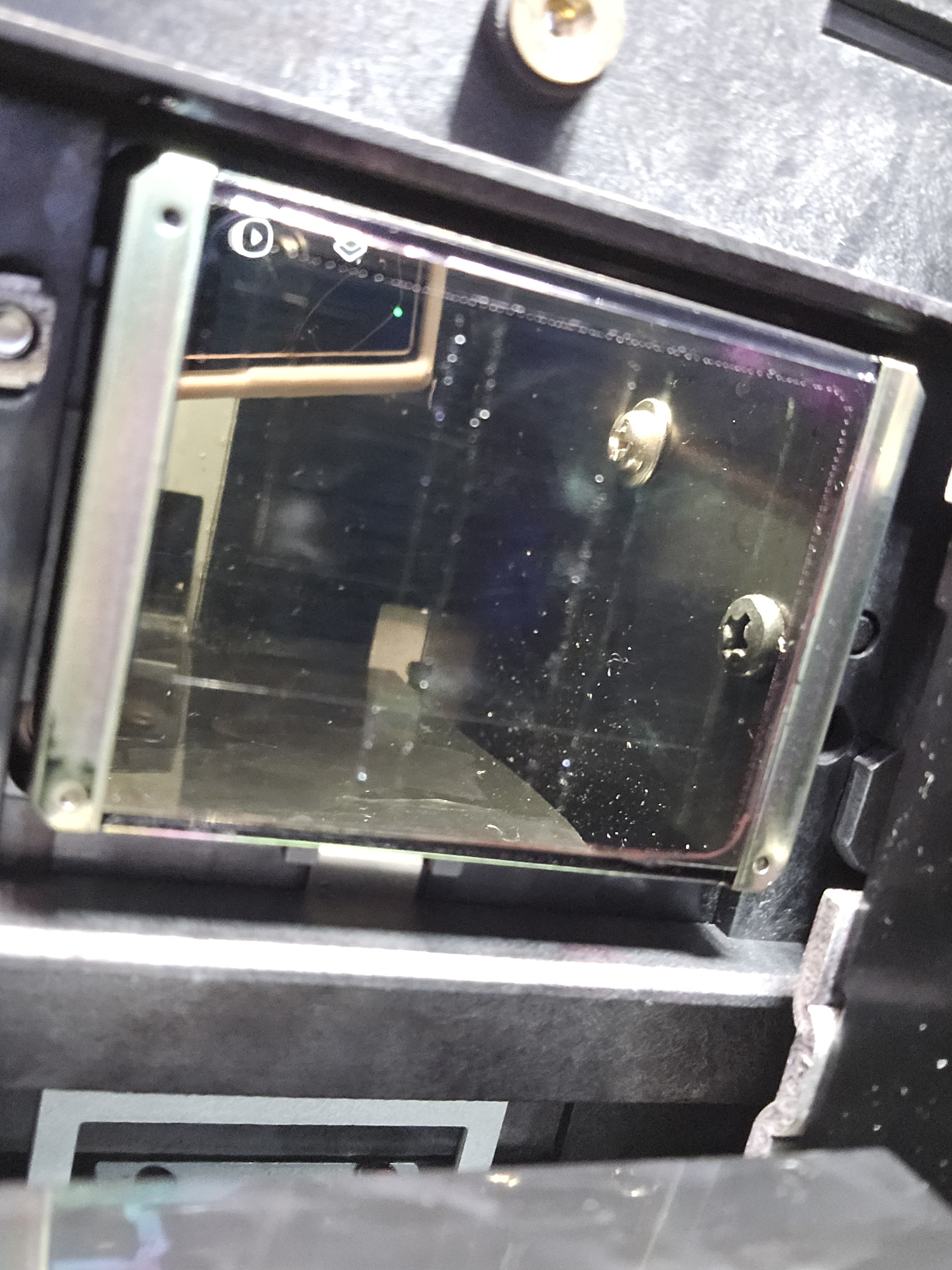

Thank you for your reply, I have today changed the cap top, there was no change unfortunately, I am speaking to roland support now and they have requested a picture of the head, Upon taking this photo (which was an utter pain), I have noticed there is alot of lets say dust particles on the head itself. I am wondering if this could be to do with the problem, As I know your not meant the wipe the head, I have tried the usual fluid on a swab and gently pressed onto the head, but it does not seem to help or move those tiny dust particles, Would you think I would be ok to very gently wipe off the dust particles?
Kind regards Kyle.
