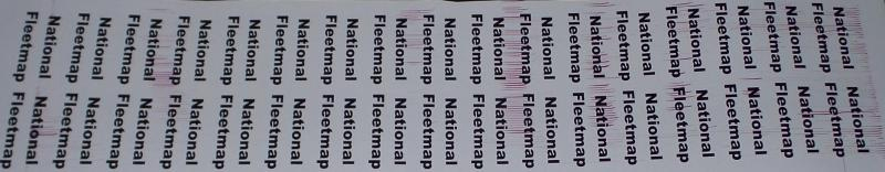

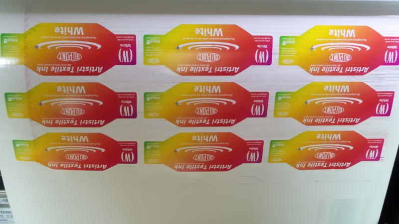

I'm hoping someone might be able to suggest a reason why my prints have streaks/lines of ink appearing in them?
Here's a couple of pics to illustrate:
I've not changed anything - same Roland ECO-SOL inks, same vinyl that is laying absolutely flat. The printer is cleaned when prompted.

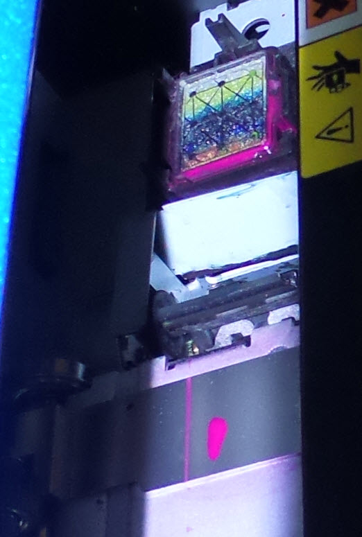

I carried out a 'Normal Clean' today and noticed a collection of magenta around the capping station seal and, as you can see, a spot has dropped onto the guide plate!!
Since the problem started I have noticed this pooling of magenta around the seal before!!
To the untrained eye (mine) I'd say the printhead surface is coming into contact with the vinyl therefore causing the streaks/smudges/lines.
My BN-20 is about 18 months old and had minimal use.
Is it possible the printhead could have come loose and dropped a little? This would explain why there's an abundance of magenta ink around the capping seal. Any suggestions?

I can print a perfect nozzle check but just have these darned streaks/lines running randomly through!!

It doesn't look like a bad printhead yet, but indeed that it's somehow touching the media. It could also be some lint hanging from it but my 0.02 is you have media buckling up. Try another media and see if it occurs again on that. Check your pinch rollers if they are dirty?
If you continue to run like that you really could at some point damage your printhead.
You really should do a manual cleaning with a swab and cleaning solution on your captop, that one looks really messy...

The picture of the cap top was taken after doing a thorough manual clean followed by a 'Normal Cleaning'. There's definitely no lint hanging from the printhead. This is exactly what I though would be the problem so made sure there was nothing there. I also checked the media for buckling and changed to another. I've even applied a little weight on the leading edge of the media to ensure it's not lifting beneath the printhead.
The pinch rollers are as clean as a babies bum :) - everything is spotless.
I do agree, it looks like the printhead is brushing the media as it prints - is there anyway the printhead could have dropped? I really could do with the service manual so I can check the fixing points.
