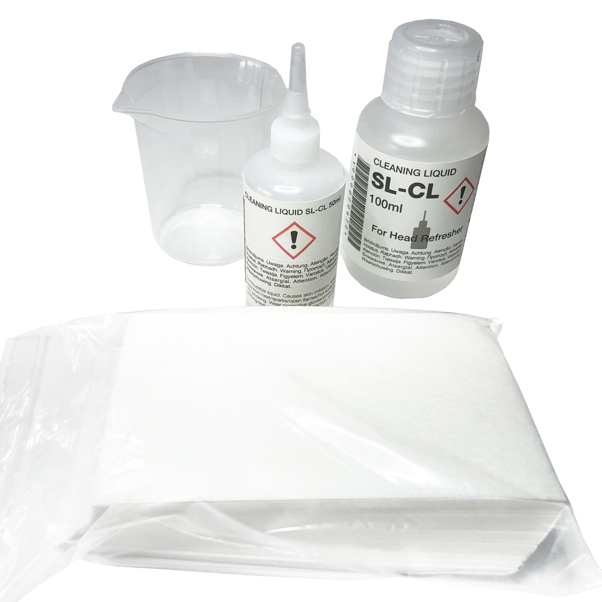

I have an abundance of Refresher Sheets in support of my LEF2-200, but I'm without a conventional source for the accompanying SL-CL Cleaner solution shown here:
Roland Tech and Supply personnel advise me that their Cleaner (in 100ml bottles) is only available in their "Kit" (w/ Sheets, pouring cup, and empty 50 ml application bottle).

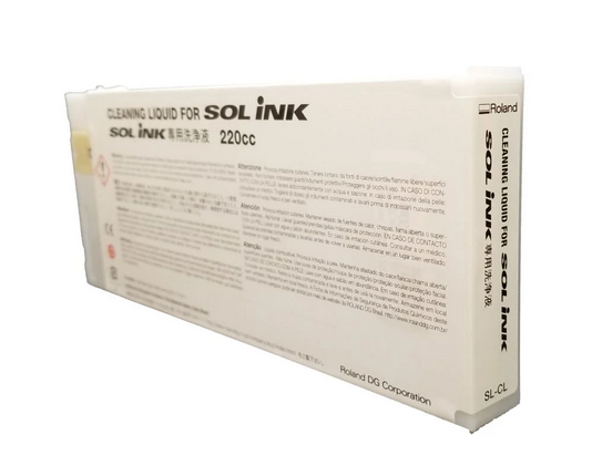

I intend to purchase an SL-CL Cartridge and remove / transfer the cleaner to an on hand bottle.
Does this sound plausible and without consequence of the majority here? :rolleyes:
Almost sounds too easy to render 220 cc of product this way.

I haven't bothered to open a used cart in years but last time I did it was an oem seiko cart with a nazdar bag in it.

One can again obtain an entire 100 ml Refresh Kit:

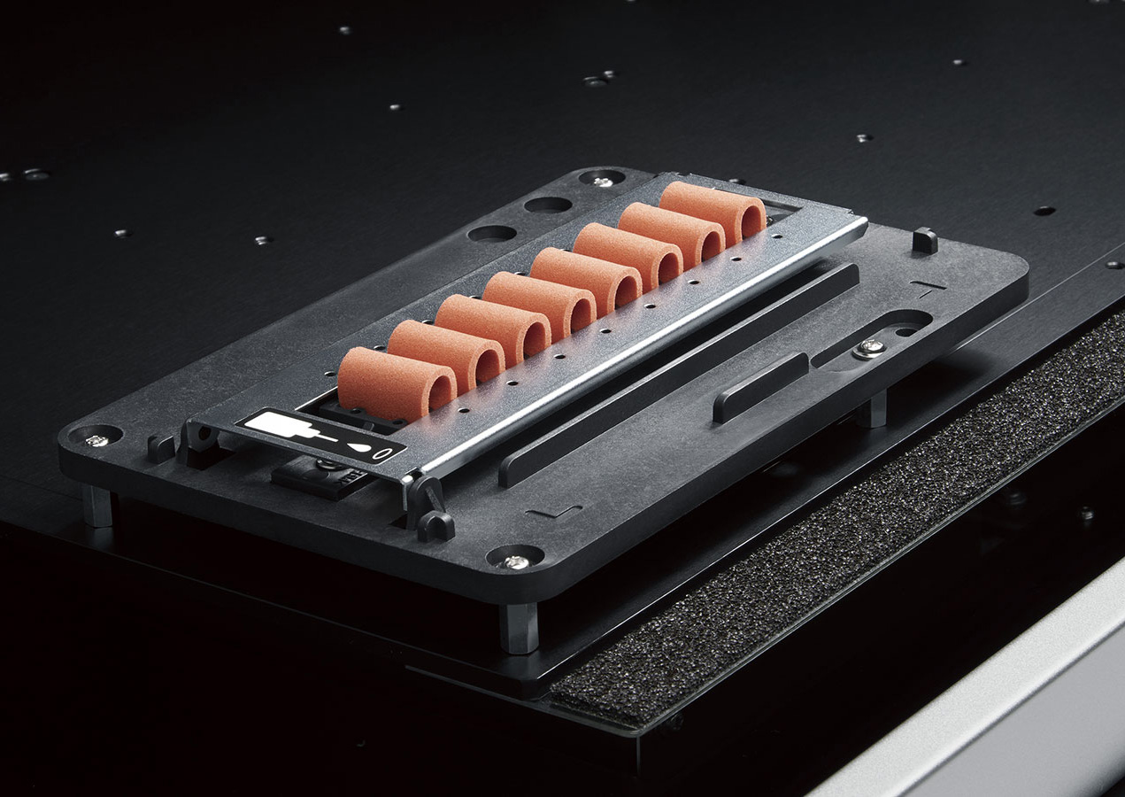

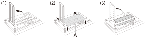

The Head Refreshing operation is applicable to the Roland LEF2 series of printers.
Here is a how-to video w/sub titles showing the equipment and steps.
The Head Refresher unit prior to affixing the cleaning Sheet:
Sheet "A" insertion;

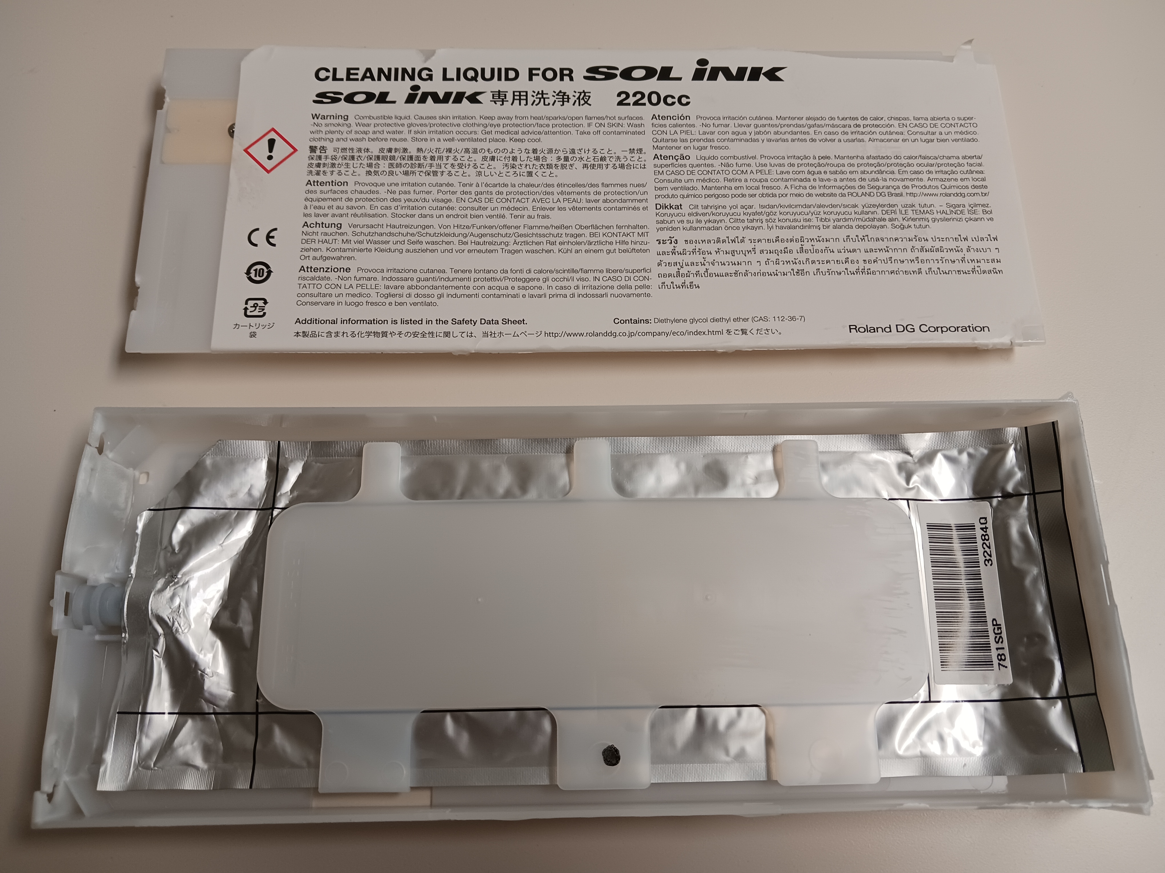

Success! Transferred SL-CL fluid without issue.
If you are curious (like me) as to what the inside of a cartridge looks like, see the glued in position empty bag shown below. The top left corner I cut to drain the liquid from. :)
Of note, the cleaner has a non-evaporating / oily feel to it. It must have a lubricating and cleaning quality as the sheet interacts across the heads. It isn't just a solvent like the ESL5 manual cleaning solution appears to be, in other words. Thus, the Roland warning to not mistake one liquid for the other in application. ;)
