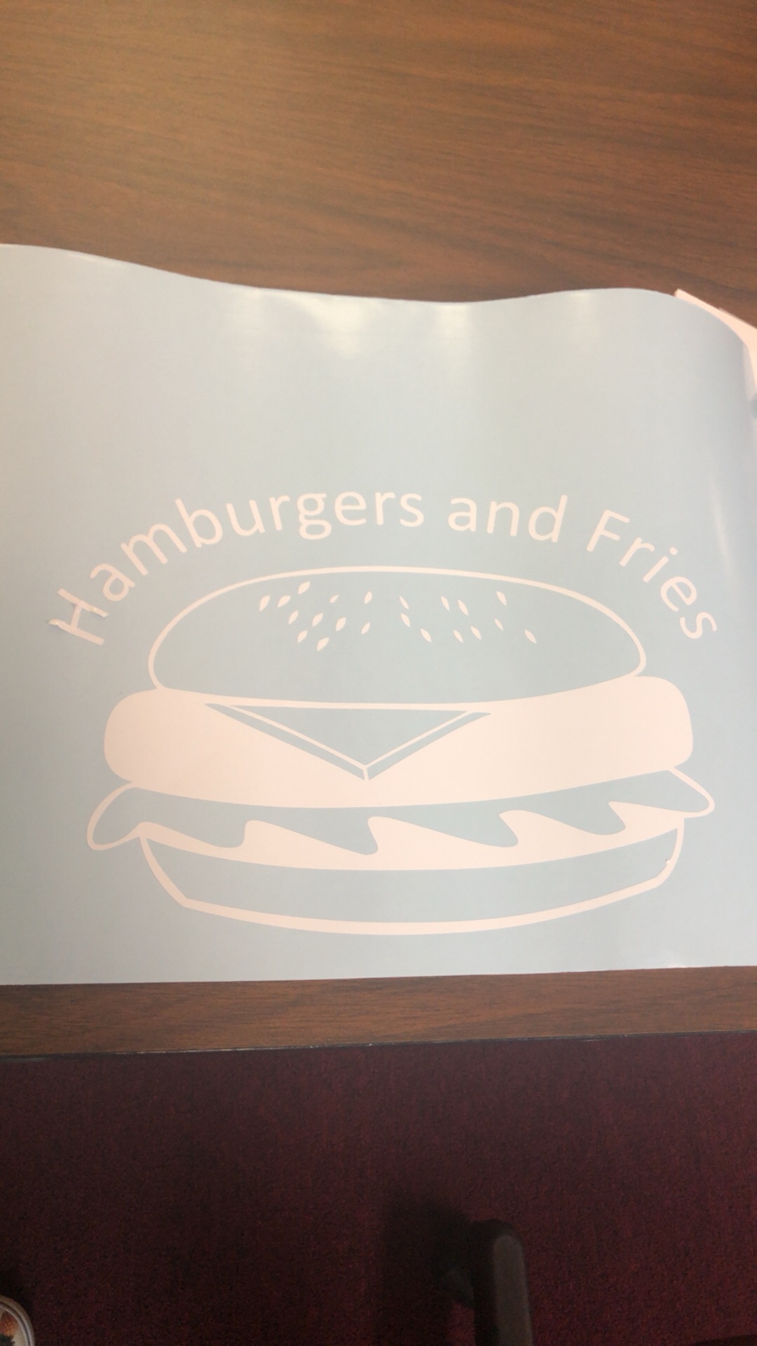

So I tried Inkscape on the old vista setup and even with the Roland drivers I was getting some errors. A friend of mine helped me out on the newer computer running windows 7 and using the GX24 drivers and tested the cutting with the demo version of vinylmaster cut. Worked fantastic!!
I purchased vinylmaster and should be able to make some Christmas gifts!

signsbyjess
Test cut from demo
