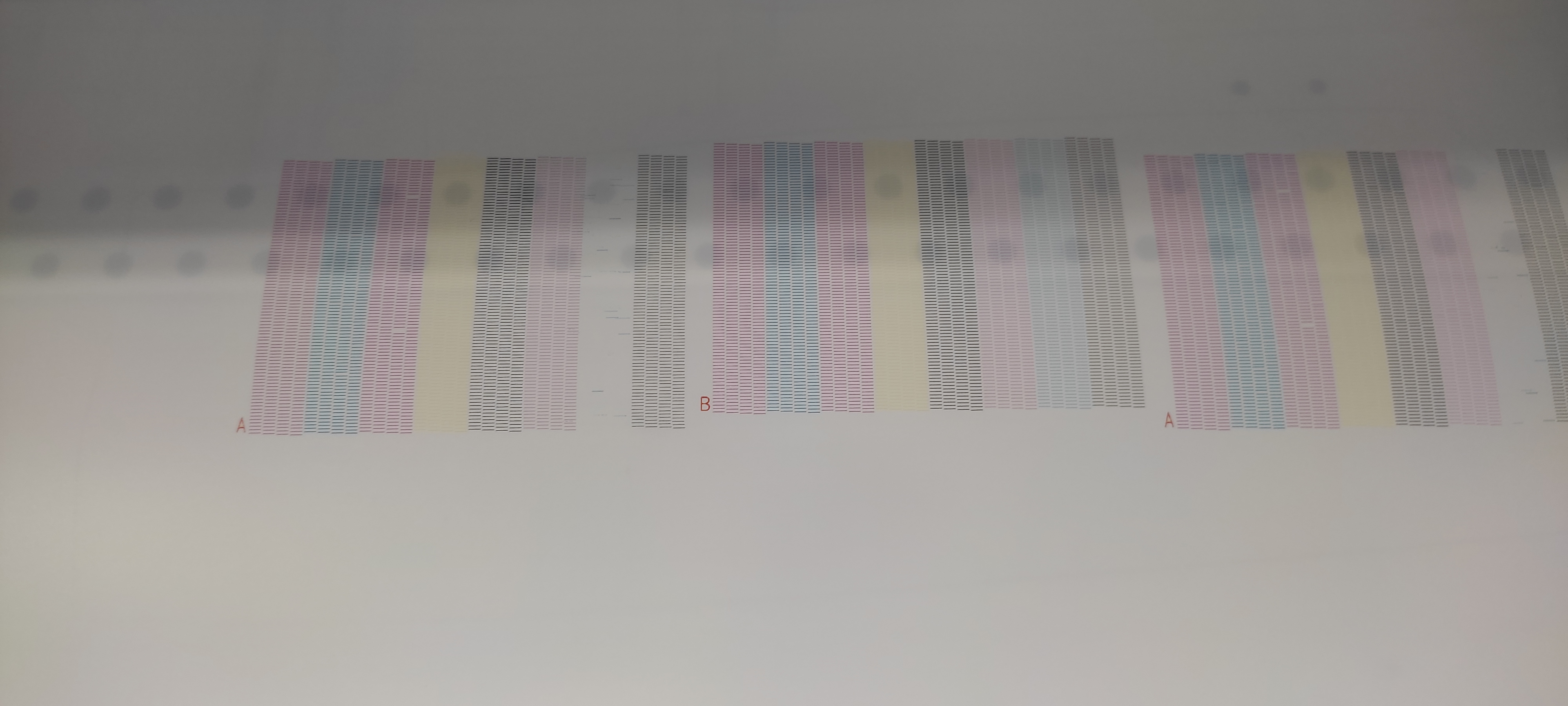

Hi
we have a problem with the roland on the head And it turned out to be blue, the service was here with a knife in the back, he changed the dumper and cleaned what needed to be done and now it's gone again.

Hi peter1313,
What is your color setup? Had the same issue and we changed the head. However before you do that you can try to check if the head is sitting properly on the capping station. You can also check if there's any difference if you go with a Medium head cleaning.
