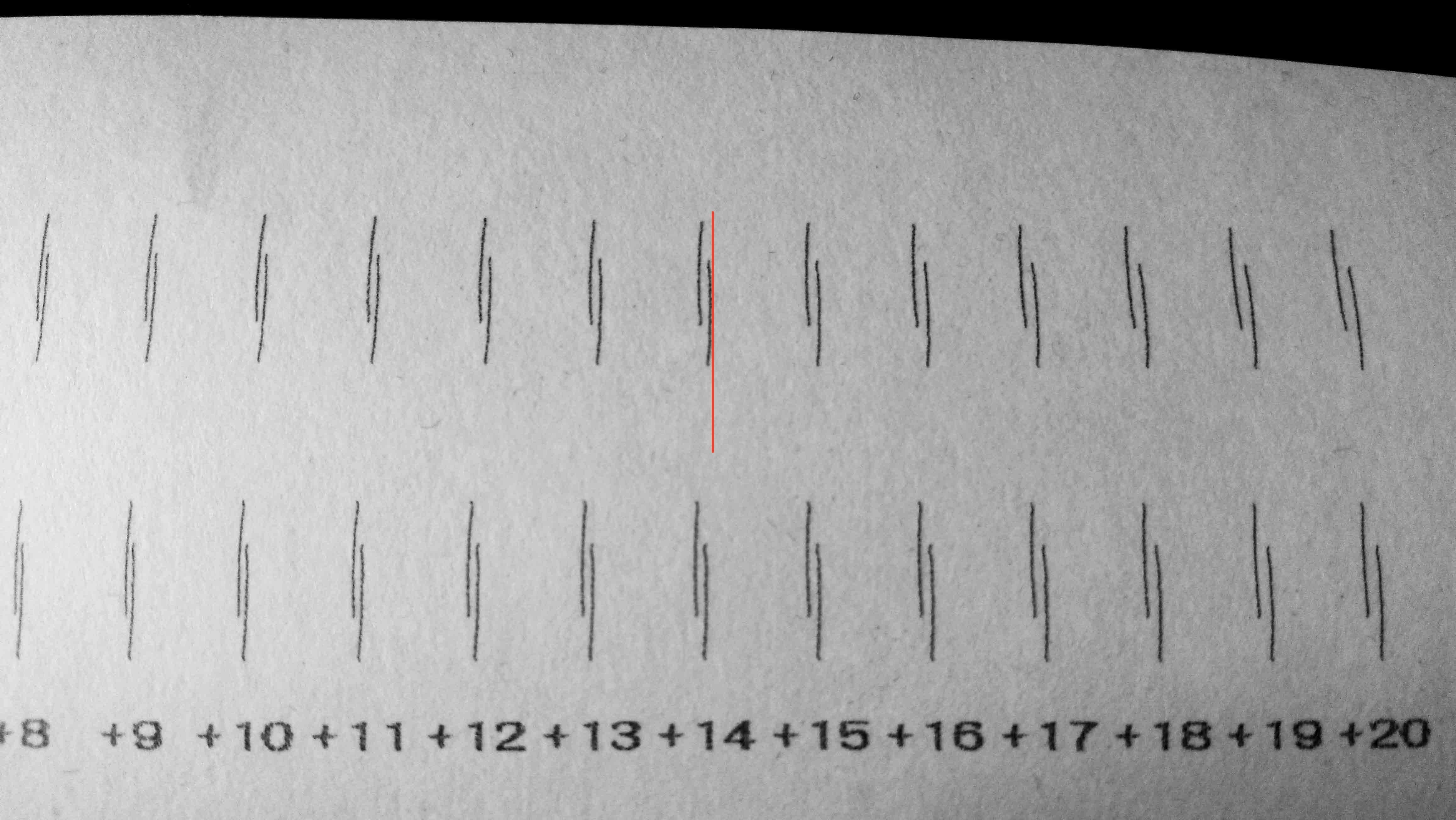

Good day, which can help the problem so that the BI-DIRECTION test on the plotter ROLAND-FX640 lines does not rove, it paper for sublimation.
How are the islands in the middle of a passage and in another other passage,
The lines themselves are not direct, the years were pressing straight
Bury gratitude ...

I have run into this issue only once in my career and it ended up being bad ink. We changed the print head, cables, slider and main board. We ran calibrations, checked electrical from the wall and even flushed the whole system and changed all of the ink flow parts. After putting OEM cartridges in, it fixed the issue.
Triggerhappy
Is the correct value out of range? not really clear from that picture. If yes, you need a tech guy, service menu and adjust the default values.
PS.: That is one bad ink. Those lines should be straight as hell.
