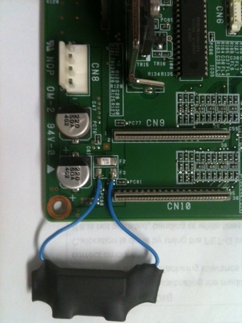

F2 on the mother board. It's about the size of a grain of rice. 1.6 amp.
One of those things where "if you have to ask"...
I actually soldered two wire leads on mine and replaced with a standard fuse holders.

Haven't had to fix F2 yet.
