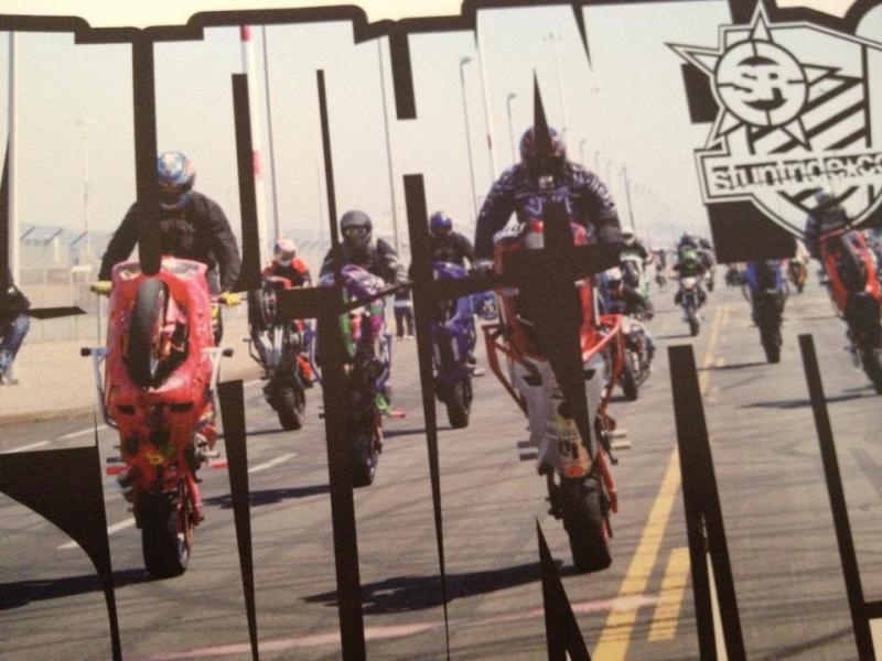

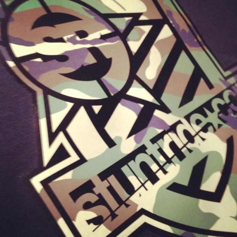

So I finally decided to buy a roll and test it out in my versacamm.
I'm impressed, its durable, looks crisp and clean, doesn't feel extremely thick and thusfar it has worn very well.
8-9 laundry cycles later (high heat, no inside out), the feel is worn in, it feels better after a few washes. The print definition is exactly the same. No signs of peeling, and ive stretched and streched but have yet to make a print crack.
I dont recommend anything that needs much weeding, thats a pain... of course I dont like weeding anyways.
