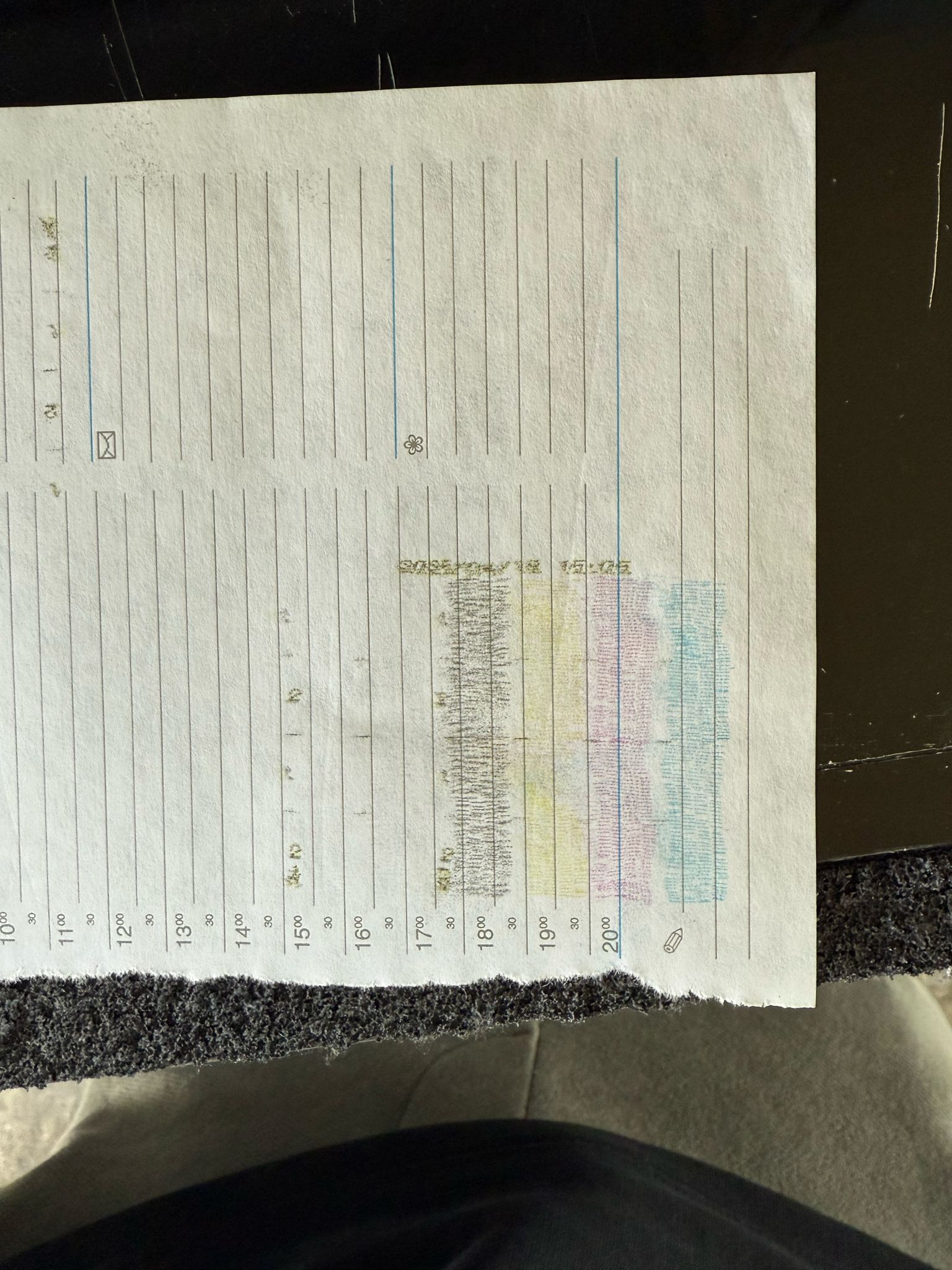

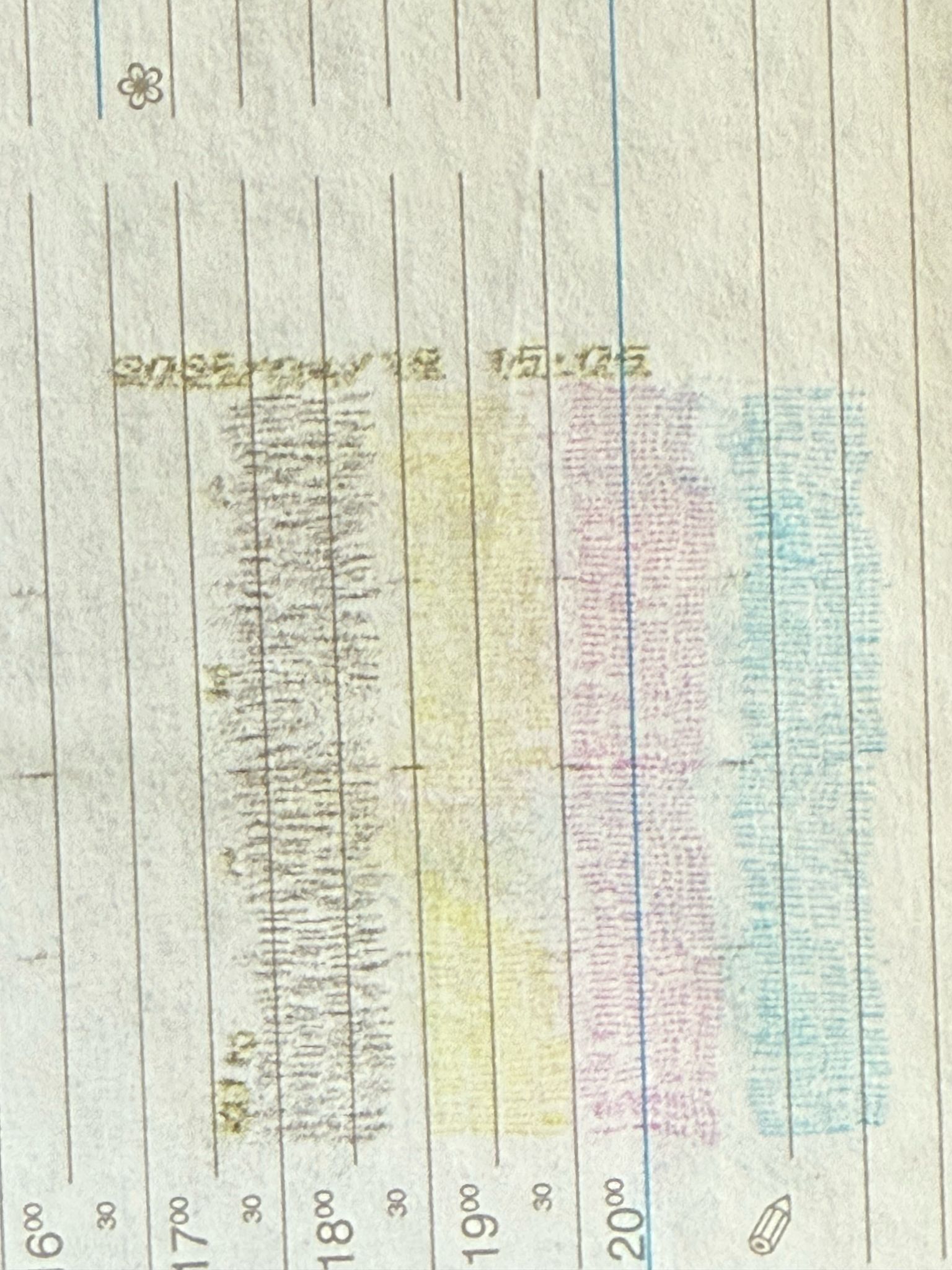

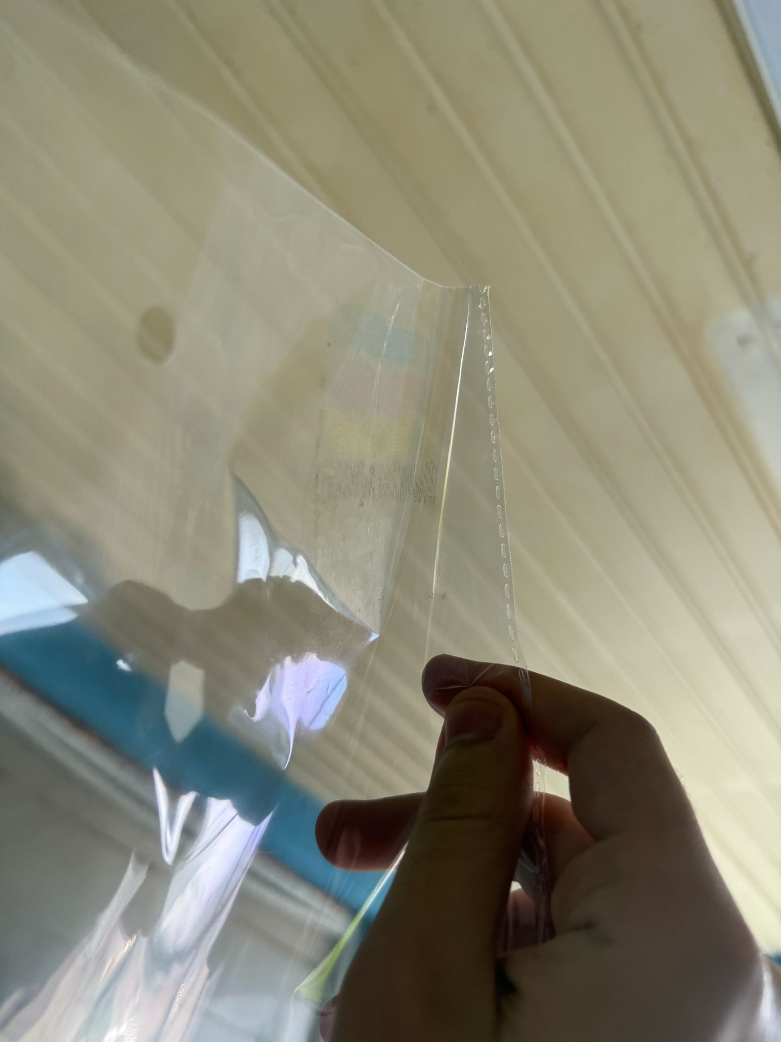

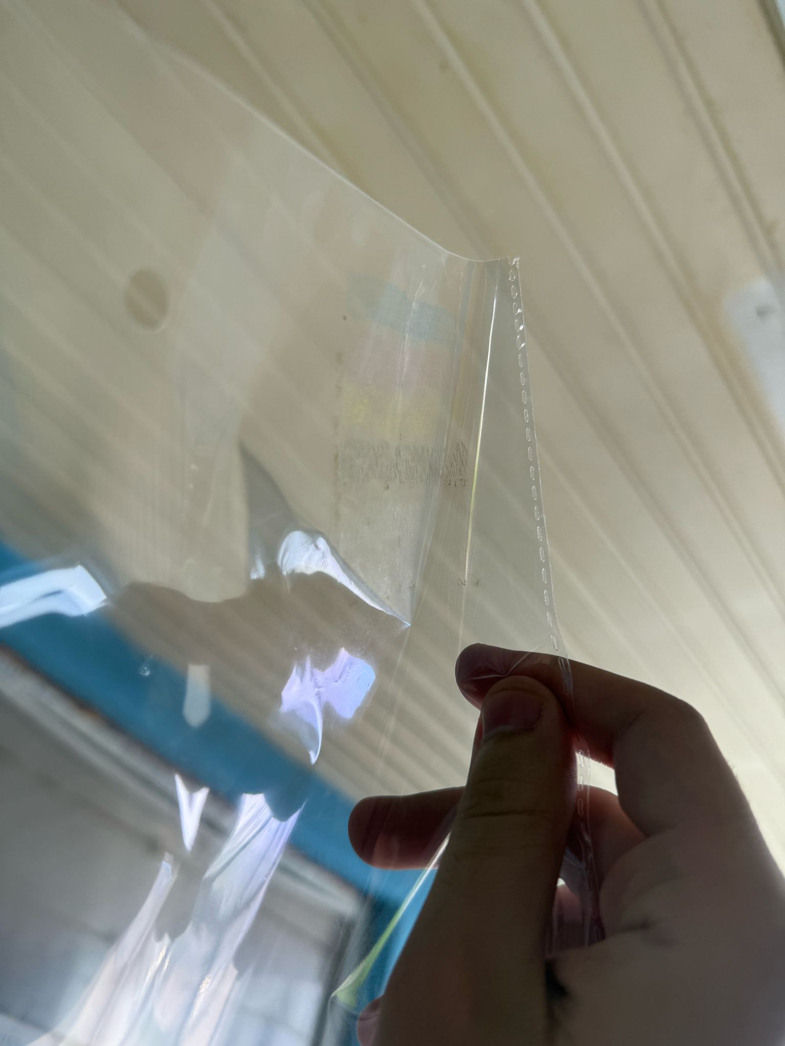

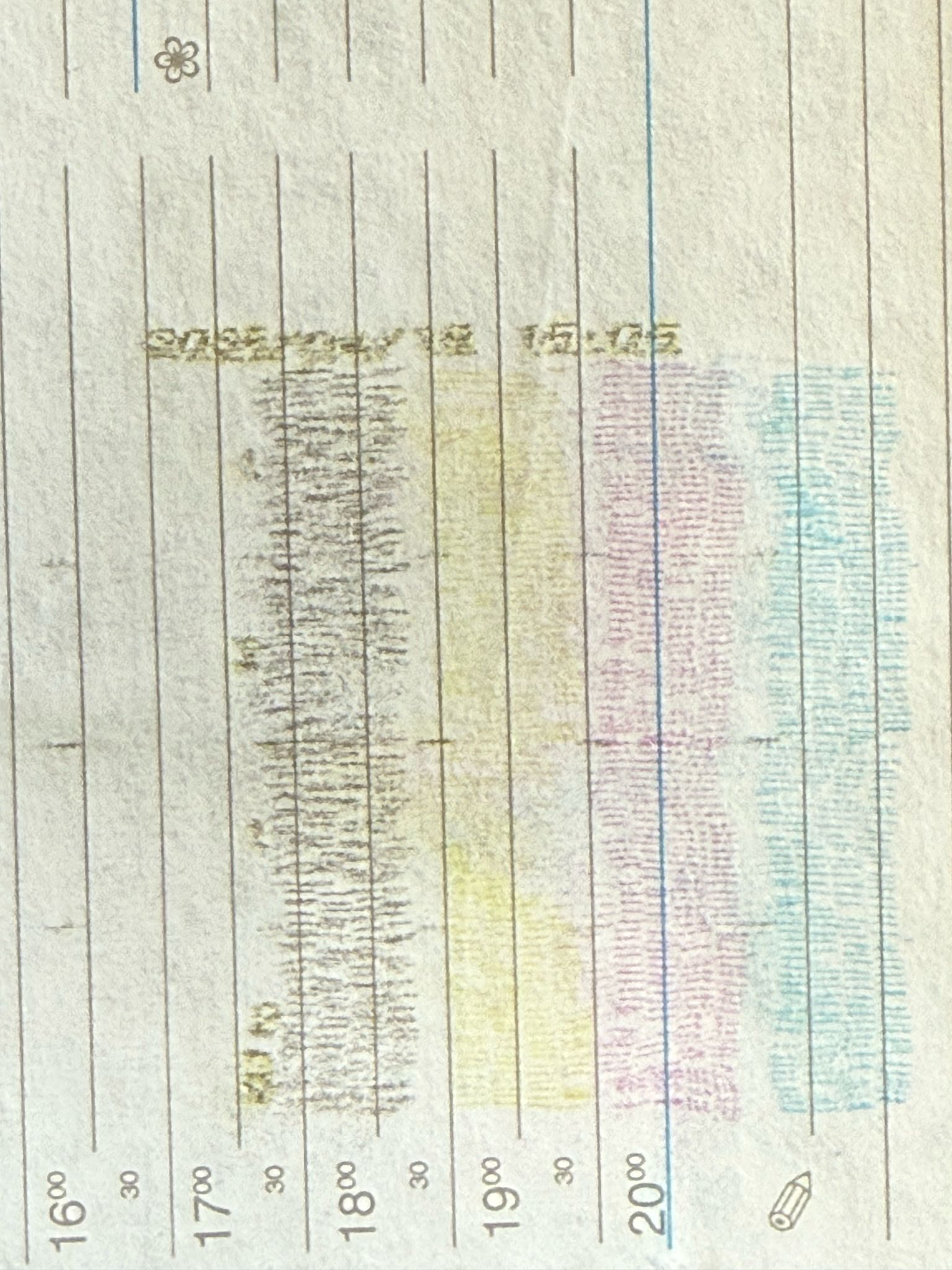

Hello again, today I received some samples and nozzle check. It looks like a mess but at least nozzles are firing. In your opinion it looks like a mess because are not alligned or heads are all compromised? Is it any chance to bring this back to life? I am prepared to invest some in it concerning the low purchasing price. Your help and opinion would be highlly appreciated. ALso any tips in checking the printer also, on what to check hence I never had something to do with UV. Thanks!

cornholio
You need to do a complete flushing of the tubing and be prepared to replace all heads and dampers. Most customers I have print small high quality stuff like watch faces with these printers requiring the heads in mint condition...
