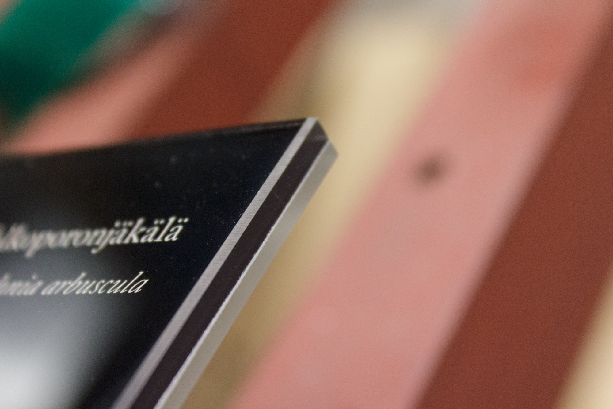

Yes, but of course, adhesion promotors improve the bond. It's important for us because we normally laminate prints in glass oven and post-processing can break the bond between ink and glass, if the adhesion isn't very good. Less ink also improves the bond, so a good "stress test" is to print maximum ink to see what these machines are capable of.
We wash glass with a glass washing machine, apply primer and then straight to printing. I think the washing makes a great difference in adhesion, because glass sheets have small powdered coating that keeps away friction/scratching but most people won't have this machinery unless they are operating primarily within glass industry.
