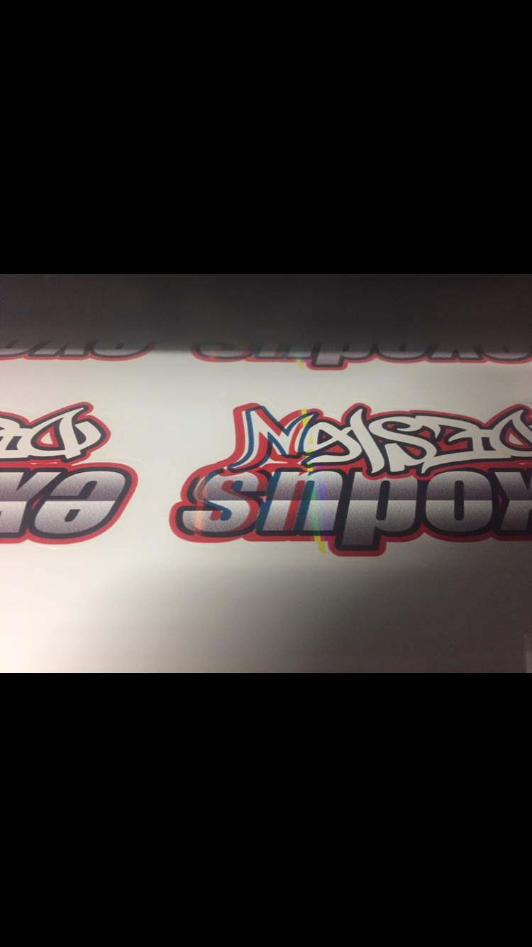

I've had no problems with anything all morning and then this afternoon i'm getting an unusual ghost/line error in the print in the same spot on the roll regardless of what i print or print/cut
Looks to be almost below where the encoder strip folds to go back on itself above.
Anything to the right prints fine (and cuts fine) there is this weird patch, and then anything to the left is out of alignment print/cut
Crap on the encoder strip perhaps?
Wondering if anyone else has had this issue
Same issue on 2 pcs, running versaworks and tried multiple files and profiles
Seems electronic issue with printer itself but curious to see if it could be something else

First off, the encoder strip doesn't fold on itself, that would be the cut carriage cable. But you are probably right in that this is most likely a dirty encoder strip and it is probably somewhere in the middle.
The encoder strip goes the full length of the printer and appears to be a gray transparent piece of plastic. Clean that off with a soft, lint free cloth and some isopropyl alcohol.
