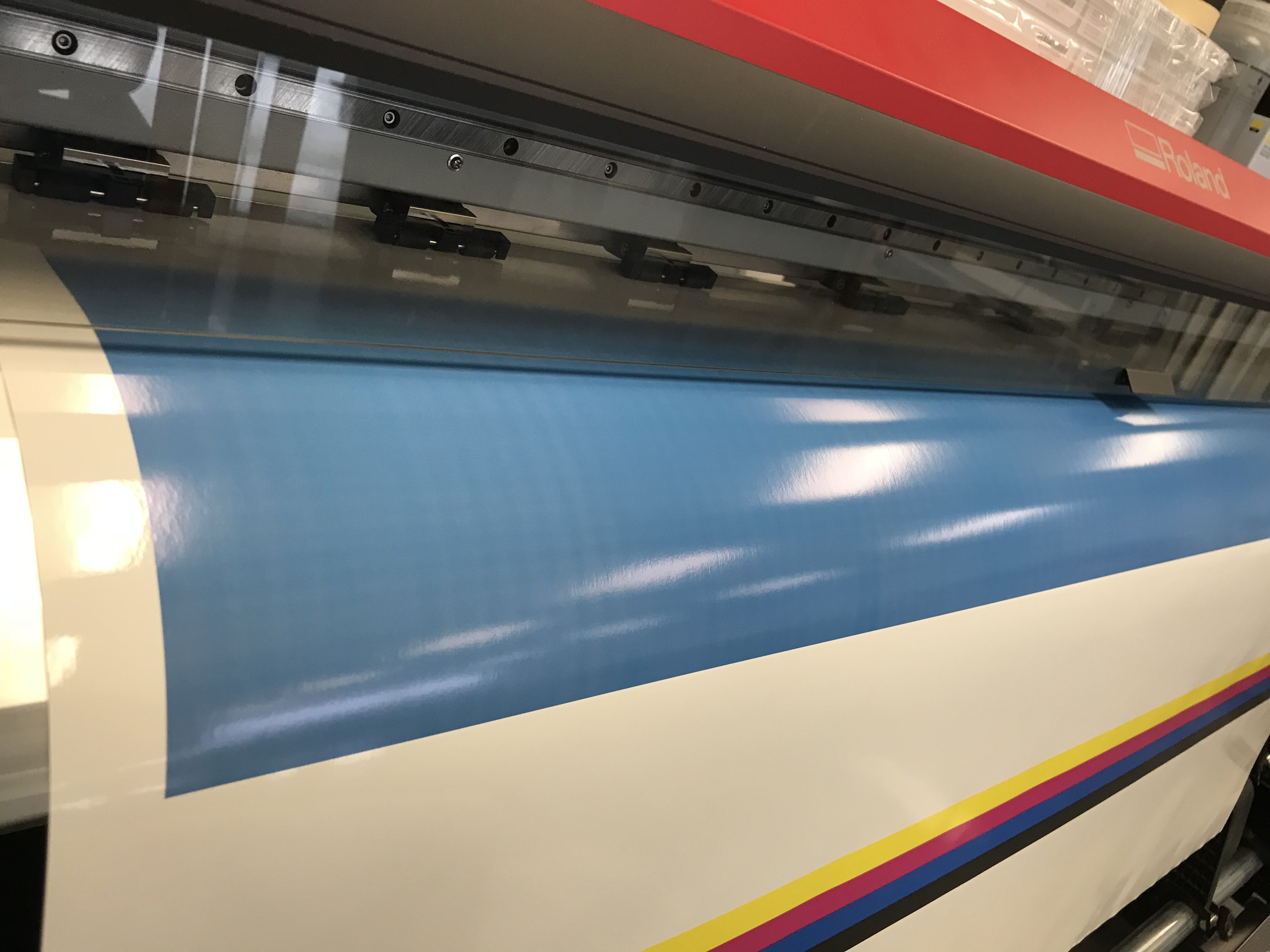

BUMP this thread. I've had the same issue with mine since it was a brand new machine. Any ideas for a remedy?
You can check if it's ink starvation if you set a 1sec pause between scans. (you should be able to set this on the printer) The idea is to let the head go with it's normal speed but let it sit between passes.
Charlie J
Today I replaced the dampers in my machine hoping that it would fix my issue with cyan banding on the left side of the machine.
Any ideas?
