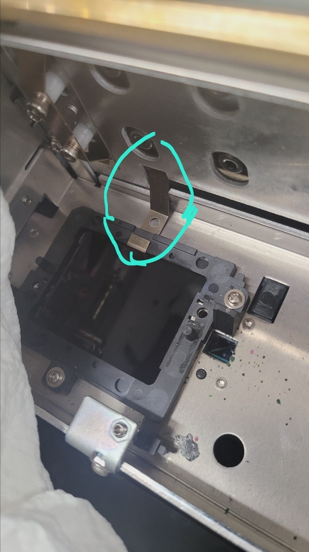

hi. so yesterday i replaced on my roland rf-640 the printhead, capping station, ribbon cables and dampers.
it was the end of my work day, so now i am back and when i went to print something. it looks like everything is GREAT.
except for now there is a clicking sound when when printing everytime the printhead returns to the capping station.
i spoke to a tech, and they advised me to remove the ground clip to see if that was catching and causing the clicking sound.
unfortunately that did not stop the clicking. he is out of ideas, and i have no idea what to do here.
any tips, tricks, advise?
damonCA21
Check the main print cable, the long one that goes from the print carriage board along the top of the printer. Sometimes if these are disturbed they can stick up a bit and the plastic guide can click against the inside of the printer
Also turn the printer off with the head free and very slowly move it from the print area back to the capping station area and see if you can find out exactly what point it is clicking at, then you can investigate around that area to see if you can find the cause
