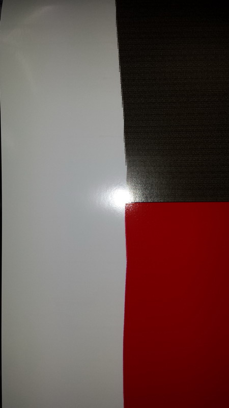

Roland RS-640 not Printing straight has anyone had this problem.
The printer has done a far bit of work and thinking it could be a motor
FrankW
That symptom is typical for the encoder strip, haven't had any motor issue with these symptons in 17 years of roland support. If cleaning won't help, it could be that it is damaged. If this is the first time with problems with the encoder, you could turn it upside down.
