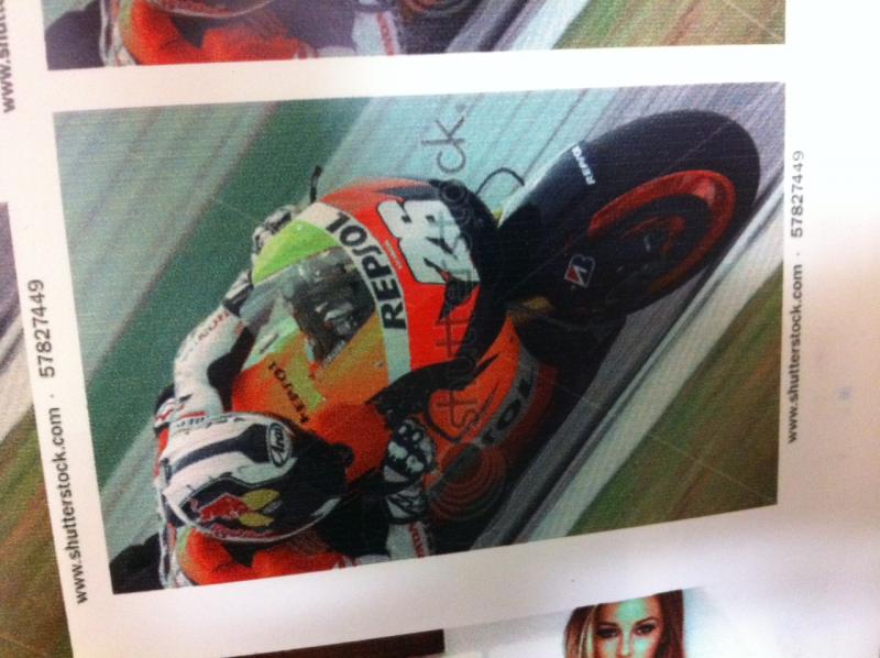

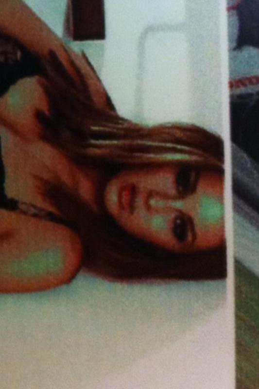

The ink Im using third party ink from solvent ink online. ( the bottle says clink) i was thinking of grabbing oenm ink though. Material I am using primarily Arlon dpf4560 calendered for basic and Arlon dpf6000xrp cast for wraps etc. as well as the arlon dpf 313 banner material. The local supply house recommended that over oracal which I have access to throuh an out of state vendor. The profile I have had the most luck with is from arlons website.... ARLON DPF4560GT ROLAND PROII_V SC545EX 2xCMYK EcoSol MAX Flexi 8_0 I am running that through flexi and have gotten some adjustment but notice that blue green comes through on certain things like the reflection on a persons forehead in an image that ive printed and on an orange motorcycle one spot comes out lime green.
jsri
Heres are some pictures of the two prints I mentioned I zoomed in on her forehead since shes in lingerie didnt want to be a distraction haha (or offensive). and if you notice the right hand side of the windshield on the bike should be orange not lime green. Maybe that will help more. Thanks again

CS-SignSupply
Profile: PROII_V SC545EX 2xCMYK EcoSol MAX....
You stated that you have the SC-500, not the SC545EX.
BIG DIFFERENCE.
Try using the ESM-GCVP Profile in Flexi 8 for the SC-500.... make sure your setup is for the SC-500 and not the SC545

The SC-500 is a 6 color machine and the profile being used is for a 2xCMYK.... the 2x does not mean LC and LM. 2x = CMYKCMYK. Using a profile for 1 model of machine on a completely different unit will not work.

Bpi, I tried shutting off the color correction which I'm guessing bypasses the ICc profiles since it blacks that field out. That actually kept the same issue but dulled the whole image down. Also I am now figuring out it seems to be affecting primarily Jpeg or bitmaps. I can print a file that I have created in flexi. It's a little dark but the right colors. also had a customer send a omg which again printed ok just dark. So from what I see it's just files I pull off the Internet.
