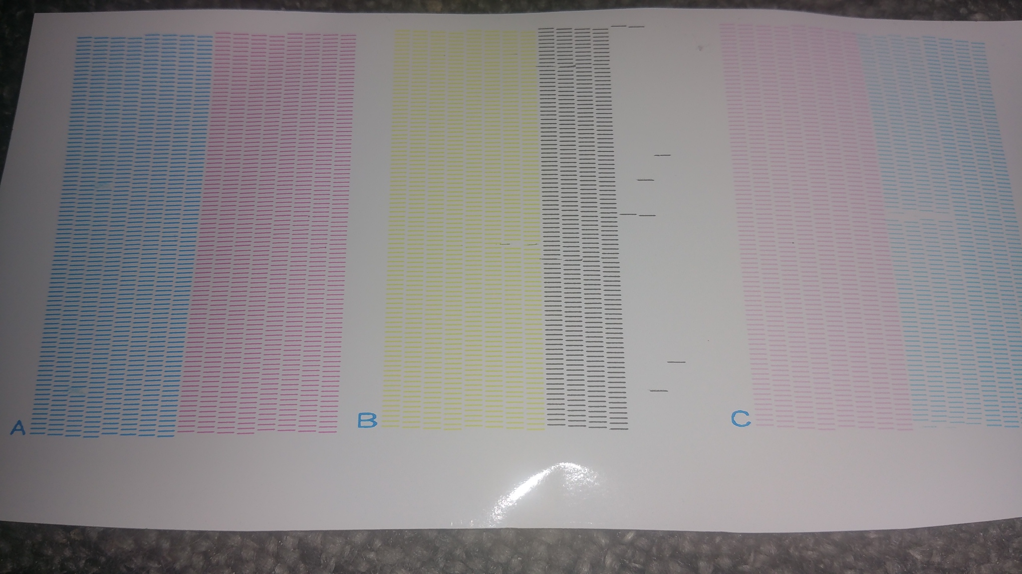

Hey Guys
I've got problems with my 545 printing black.
As you see on the attached photo, black doesnt print on one channel. After a few cleaning circles it prints just fine.
But only for about 1/2 meter, then it drops out again.
Before i have to call the tech guy i thought i ask here, maybe its something simple i'm able to fix by myself.
Thanks in advance for every hint.
Dan
Jester1167
Possibly a bad/clogged damper.
Dampers are cheap and easy to replace. Be careful when installing them. You don't want to break the nipple.
Solventinkjet
DIY Printer Fixing Guide
Yeah it's probably a bad damper or cap top. Also, flush the pump tubes to make sure they aren't clogged.
