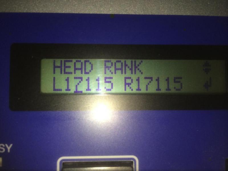

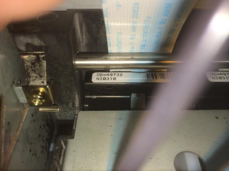

yes i have new heads and there are number written on top of the heads as attached but im not sure if they are right as the roland will only let me change the second, third and fifth numbers on both heads.

Ken, I have a couple of these older printers and hardly ever enter in any ranking numbers,, and the printing is just fine
if the print head comes from Roland it may come with ranking numbers. otherwise it may not..
