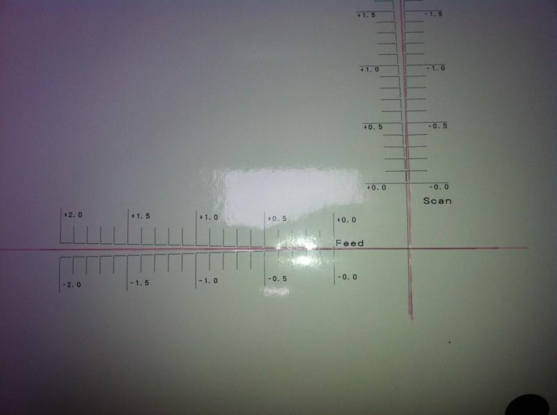

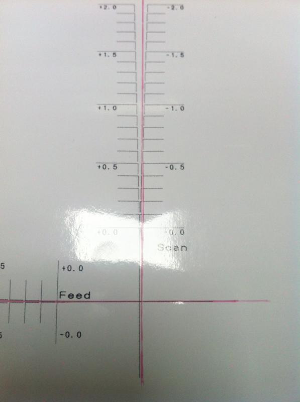

also when i want to do a print and contour cut around the printed logo the cut always seems to be too far to the right of the logo. now i have tried using the print and cut test and set up function on the printer itself and the feed portion (which is the top and bottom contour cut) of the print and cut is spot on but when it comes to the scan portion (which is the sides of the logo to cut) it just wont centre the cut line right up the middle as you can see from the pictures.
any help would be greatly appreciated as other than these little problems it is a fantastic little starter machine.
ive marked the cut lines in red biro as it is hard to see the cut line on the white vinyl.
