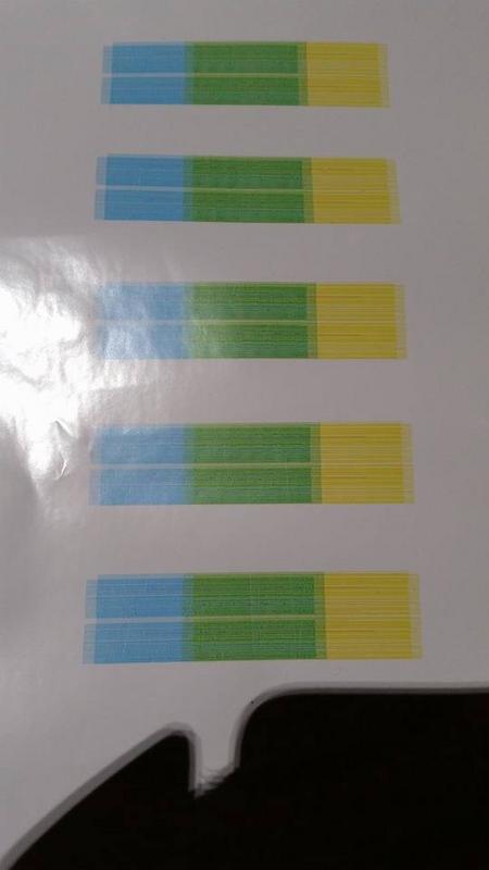

Hello everyone. I am new to the printing side of sign making and have a roland sc500 printer/cutter. The machine cuts fine but the cant get the printing side of things working properly. When I do a test print i get the result as what it shows in the attached file. Hoping someone can point me in the right direction to get it working correctly. Thanks in advance

I used to have an sc500 and that doesn't look great. Get in touch with Roland. I'm based in Sydney, and I find their tech support to be excellent. I see you're in Victoria, so there might be a different office in Melbourne you could ring. They only have a small team and sometimes you have to wait, but they are worth the wait.
Send the image to
support@rolanddg.com.au
You could try a manual head clean, but to me, that looks like a serious problem, possibly a new print head is needed, thats going to be $1k - $2k.
It's an old machine, so a new head is possible. You need to consider if you can justify the expense. From my experience that machine is a work horse, for solid colours it is fine. Newer machines are faster and have a wider gamut, but I find solid colours are where it is at for signage.
Since the machine is old, and likely out of warranty you should consider using a bulk ink system. A lot of people swear by them, and you've got no warranty to lose. I don't use them myself because I have a new machine, and a warranty to maintain. Search on this site for the ink systems, you'll find some info. Third party bulk ink is a lot cheaper to run.

Best thing you could do is get a certified service tech in and do a complete tune up on the machine. They will check everything and get it running at 100%. It is usually not too expensive. I had a guy in for about two hours and he only charged me $150. He adjusted everything on the machine and now it runs perfectly. Best money ever spent.

Are there inks still available for the 500? Not sure it could be retro fitted to use Eco-Sol inks. Oh yeah, as for the test print.... YUK! :)

I still have a and use a SC-500 for the simple and quick works and for cut only. My opinion is that you need to change or refubrish your captop. Maybe it is just the sponges. Have a look on this, its condition before proceed further.
