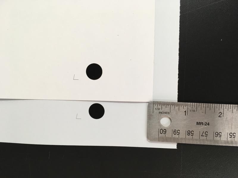

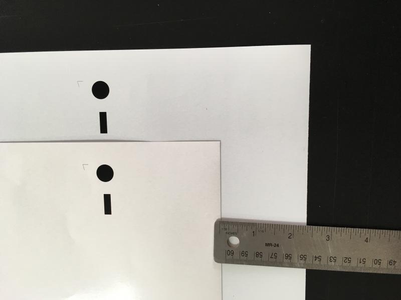

Really? 2 1/2" more waste on this new machine compared to the SP (see pics).
Can I drill out another hole for the sensor? What a waste!

Call your dealer....it maybe a setting inside the rip where it chooses a gap between jobs or start of job. We had the same problem we thought with the soljets spacing out too much but it was because of a heater setting enabled.
bayviewsignworks
You can see the front sensor, it's quite a bit further away from the cut strip. As much as we're saving on ink we're loosing on media.
oksigns
Change your Page Space under Printer Controls in VW.
Horizontal margins are determined by pinch roller position. You can find the absolute edge with a little experimentation before you get a detection error to get the most out of your outside margins.
bayviewsignworks
Right but I want it as a default setting on the printer so I don't need to set this every time I print something.
There is now 5" on the front end and it will probably be at least that on the back end. Who thought up that brilliant idea?

back up the material and set a base point? a bit repetitive of a task but works well for me. i usually lineup the material with the edge of the vacuum strip.
oksigns
the SG-300 is very similar to my XR-640. If you start a new project aligning the leading edge to the edge of the vaccum/platen on the printer, your leading page space should be in the order of 40/50mm
It has become 2nd nature to start a new project on that vaccum/platen edge and to either manually edge cut where I want or set a page space of about 80mm on large multiple sheet runs. Too little page space on the back end of cut jobs can cause end of sheet/roller errors that can cancel a job.

So after I have loaded it, lowered the lever and let it see the electric eye, you back it up to the vacuum strip and tell it to start there? Is this a problem when you put it back through to contour cut?
bayviewsignworks
When I lower the lever the machine runs the media out to the eye sensor which is about 5". It starts there. My SP-300 is about half that.
tim99
yes lower the lever, let it do its thing, then backup to the edge of the vacuum strip and set base point. if doing a print cut with reg marks this wont affect it any as long as you repeat the same possess when putting the material back in for cutting say after laminating.
bayviewsignworks
Ok, I'll give that a try.
Any thoughts on why it's cutting the back end too short? Someone above suggested to change the "Page Spce" in Printer Controls. I've done that but my other SP-540 machine has the right length as a default - in the printer, not VM.

not a clue on that one, i did ask the tech about that the day he installed my printer and it seems just to be a Roland thing, he told me there way no way to adjust that. i have to feed out a little before sheet cutting if im using reg marks. if anyone did find a way to adjust it i would very much like to know as well.
