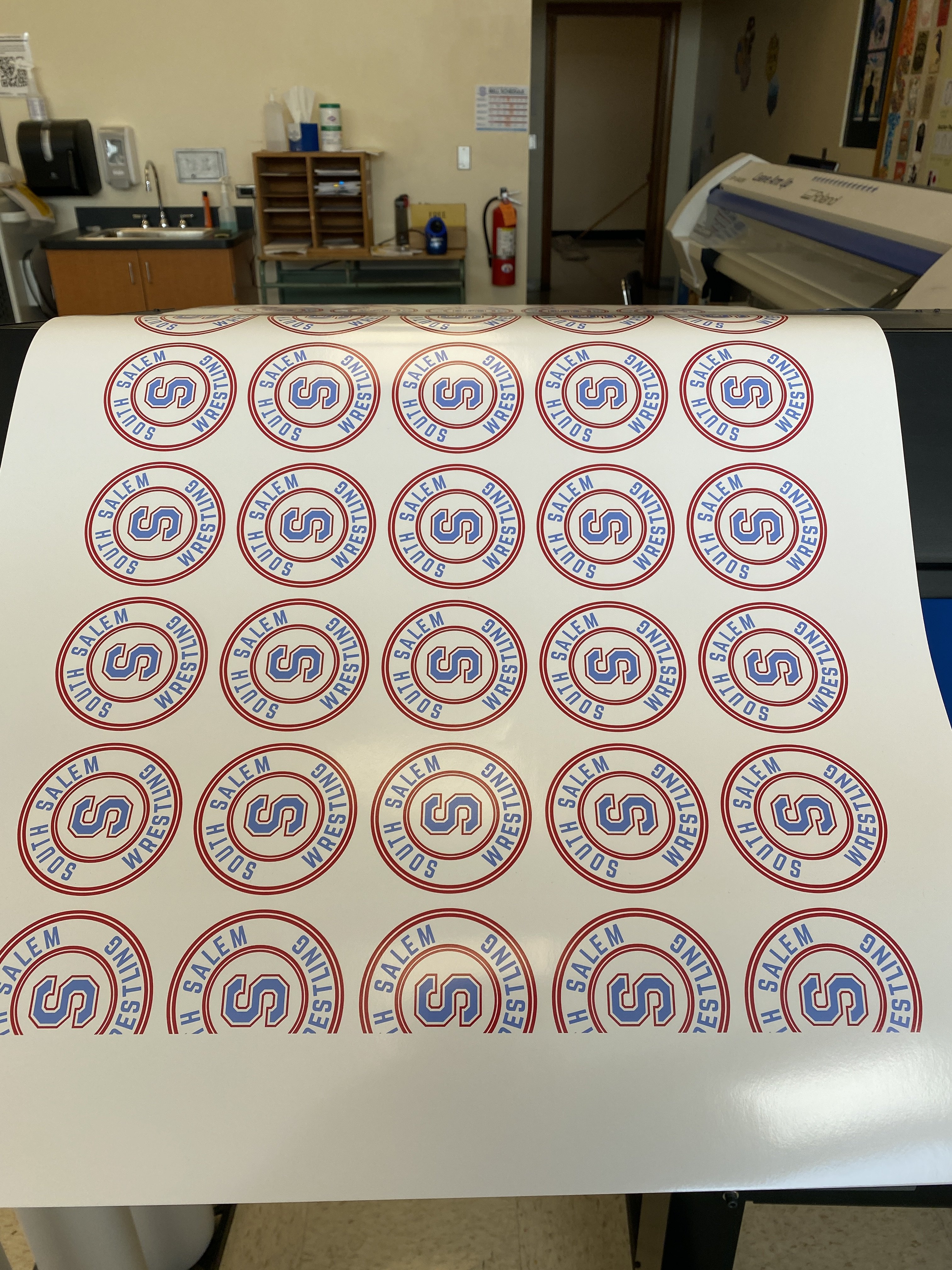

Roland SG300 keeps saying "end of sheet" and stops printing.
DAHVID
I've tried making the sheet length hundreds of feet long, drape the media off the roll so there's no tension, but it keeps wasting time and prints. Any solutions come to mind?
