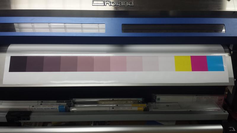

Every print I do that has even the smallest amount of gray in it is coming out with a magenta look to it.
Anyone have any solutions to this problem? And could you please explain in detal.

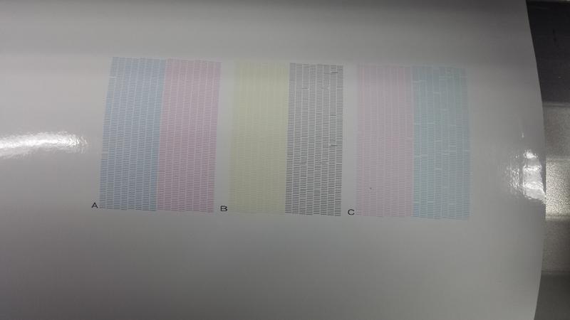

Here is a test print. Looks good to me except for a slight drop out in cyan.
Here is a print with the following values.
100%K - 90%K - 80%K - 70%K - 60%K - 50%K - 40%K - 30%K - 20%K - 10%K - 100%Y - 100%M - 100%C
As you can see, the grays are all printing with what appears to be magenta added.
From my limited knowledge I came to the conclusion that this is a profile issue. If it is, could anyone let me know how it can be corrected?

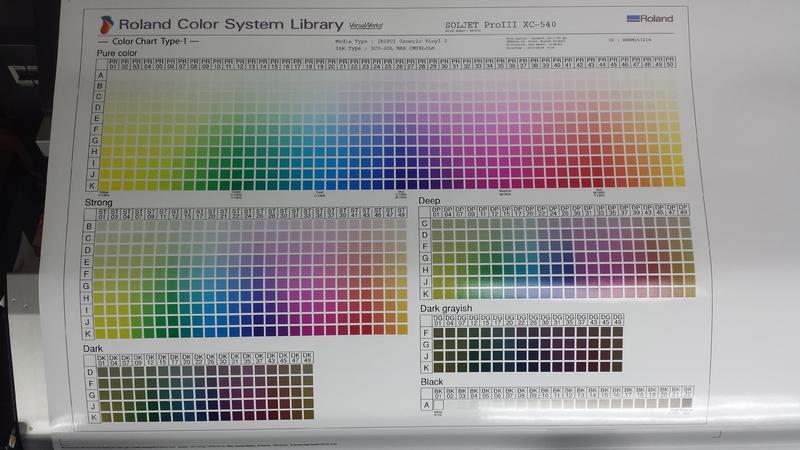

Color Chart
I printed out the color chart to see how my blacks would print and they appear to print very well.

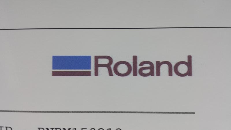

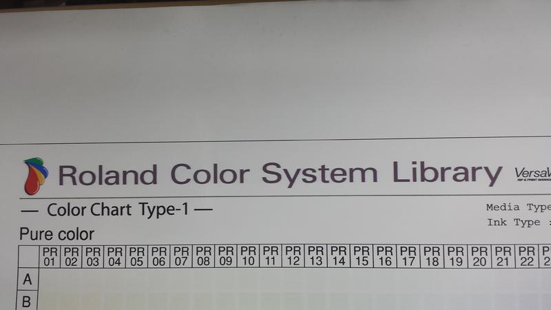

Though I did notice the "Roland" logo and "Roland Color System Library" text have the same magenta problem I was dealing with before hand.
Color Chart
Roland Logo
Roland Text
Anyone have any idea how to fix this?

John A
Head Height is set to low.
Would static cause the colors to change like that? The Roland logo text blue, this is purpleish.
