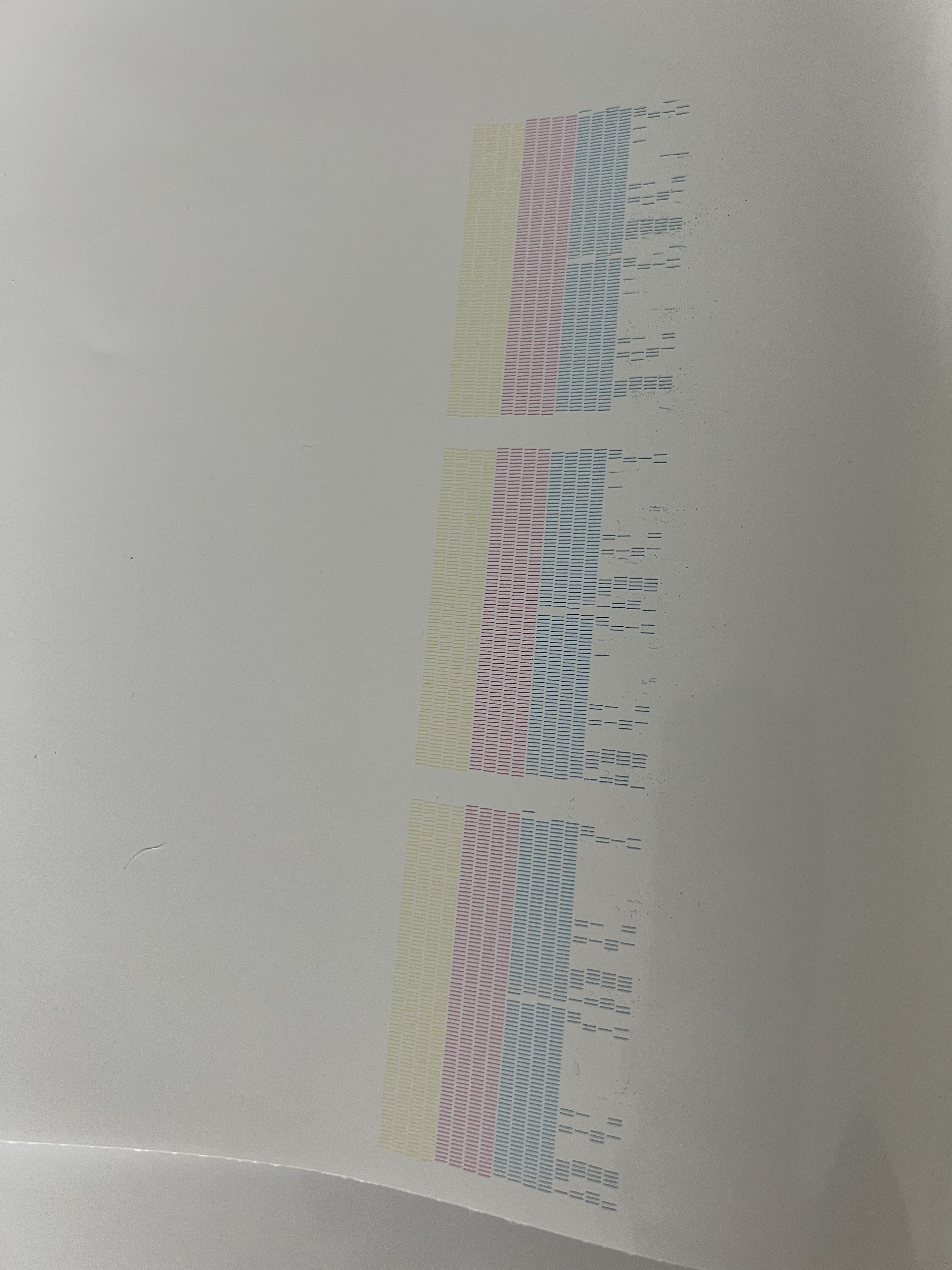

I should have attached this image in the initial post, but here is what comes out when the printer goes through test print. And when I print an image, the blacks will come out as blue.

I've had a test print that looked like that , that I was able to clear up with doing an overnight soak and a couple regular cleanings . I had tried a couple regular cleanings after I did a manual cleaning and my test prints got worse. I decided to try an overnight soak and left it over the weekend soaking. I ran a regular cleaning on the Monday morning and the test print was almost perfect. My issue came on all of a sudden in the middle of a print. It was the magenta channel I had an issue with though. But I was printing some orange and navy blue graphics and about halfway through the print they went from a nice orange and navy blue to yellow and light blue . It came out of nowhere. It was similar looking to your test print , but in the magenta instead of the black. Its worth trying before You call a tech to come out.

I have taken the waste tube and clamped it shut then manually moved my heads over so I can fill the caps with cleaning fluid then move the head back in place to do a soak overnight. Helped me at times till I needed to replace the heads. Ink can draw back up into the heads I have found and actually had C print in the black nozzles for a little bit till it flushed/printed out the C ink....just a couple good cleaning cycles did clear it too and then back to normal. Looks like your c/k head is going bad though.
