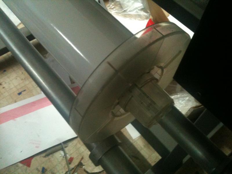

You mention that the media hangs on thumbscrews, I assume you do have the media flange rollers to insert in your material before you put it on machine.
I've attached a pic of the item, If you try to just place vinyl on rollers without these I could see that the thumbscrews could possible cause problems,
mark
