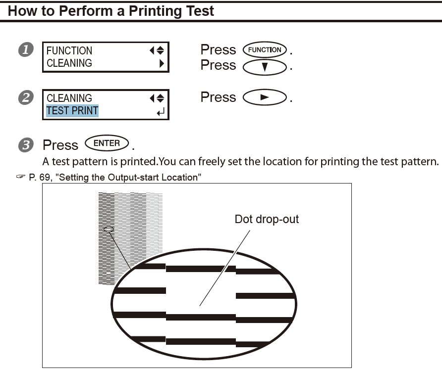

jriley
Run this test print, take a picture, and post it here please. Thanks!

Jeremy W
Thank you folks. I replaced the top caps (and the squeegees while I was in there) and after a couple heavy cleanings I'm getting all four colors, nice and clear. Incidentally, the test you asked me to print I ran before and after - before there was black where blue should be.
