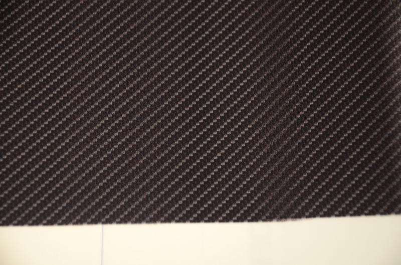

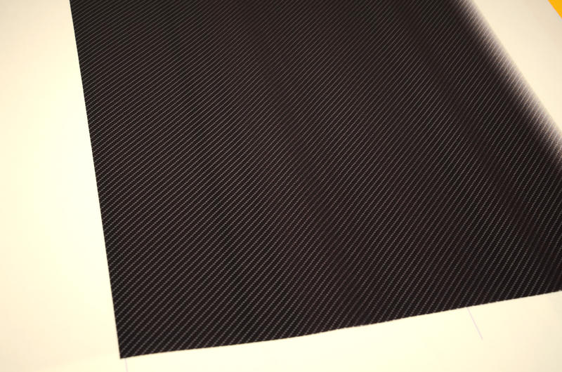

Hello everyone, I'm having a problem with my trusty old Roland SP-300V, hopefully the experts here can help. A little back story, the machine is 8ish years old and has worked almost flawless in that time. It runs maybe 10 to 15 hours a week. The only parts I had changed in its lifetime is the data strip to the cutter.
Just yesterday the printer started banding? (I think that is what it's called), picture attached. The printer may have been doing it a bit longer than I knew, but it was more noticeable when I was printing carbon fiber sheets so the color was all similar making the mild banding easier to see. I had just recently changed the black ink. This may get some angry people going, but I did switch to the cheaper "house" ink from my material supplier a few months ago. 3 of the inks in the machine were already the "house" ink, and I just finally switched the black ink the other day. To ensure it wasn't an ink problem, I put another brand new black ink in yesterday to be sure (but it was still the "house" brand).

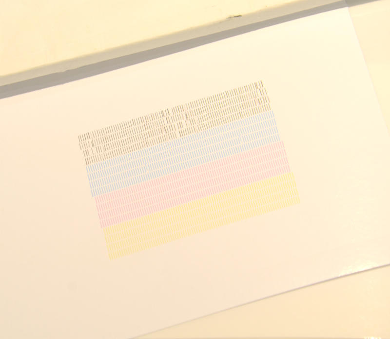

When I installed the CAPS last night, I did the swap, all parts went in flawless. Used a small syringe to draw ink through heads and caps at y-connector, ran two cleaning cycles (and I think even a medium clean). The test print is the same as it's been for a while (pic attached), pretty good, but a bit messy in the black (which it's been for a while now, but had still been printing fine).

Before I changed the CAPS last night, the print would look great for about 6", then the slight banding would start. Does anyone have any ideas on what caused the banding to begin with? Or what I can do to fix this? Should I install the new (maybe crappy) dampers? Should I just order proper Roland parts and replace both Caps and Dampers?? Should I switch back to Roland black ink? Or, am I in left field and not even working on the correct area of the printer?

Ragnabrok
Look at the edge of that print, notice the edge moves? Encoder scale is dirty, causing the print to shift. Clean the encoder scale with iso alcohol, you're likely good to go after that.
xxxmain
Ah!, Never thought of that! I thought that was just to control the cutting (as that is what I cleaned when cutting wasn't accurate). I'm off to clean it now... I'll post results. Thanks!
xxxmain
That was it Ragnabrok! Thanks so much for the help. I guess those caps may be ok after all. This forum is so helpful. Thanks again!
