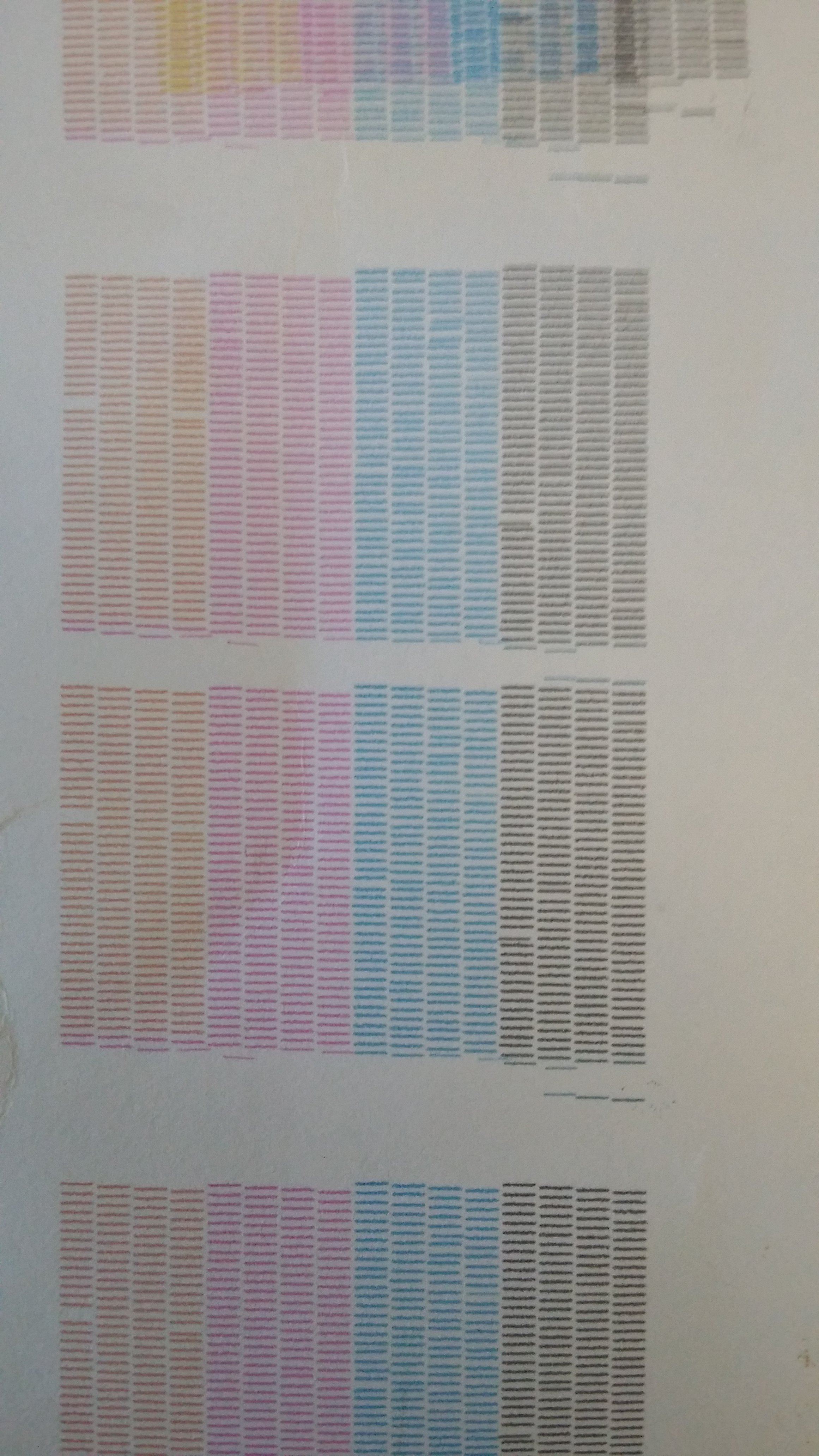

hi, Could any one please help me to slove this. Test print always show up like this . before was normal and now noticed bandings.. thanks

It looks like you could use a maintenance overhaul on that. The yellow has cross contamination which indicates that the damper may be failing and/or the cap top is worn out and/or clogged. If you haven't replaced the dampers and cap tops in the last year or so, I would start there. While you are in there you should flush the pump and make sure it isn't clogged as well.
