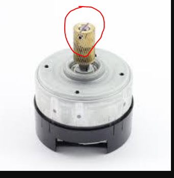

I'm sorry I wasn't monitoring this thread.
I fixed the problem with a new scan motor but it was still showing the same error.
But the thing you must pay attention is when installing the motor for the RED line to be aligned correctly with other gear.
I turned in 90 degrees and the problem was FIXED no more 0110.
