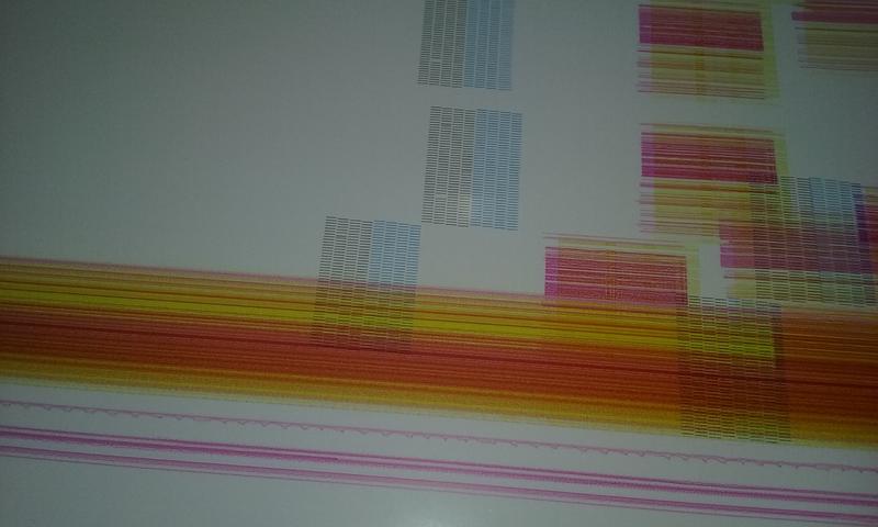

I had this error happen last night before I was getting ready to leave I decided to print one more thing. After this error showed up I restarted and now one of the print heads is messed up.
Anyone familiar with this issue?
See Pictures even the test print doesn't line up and the M Y just smears..
