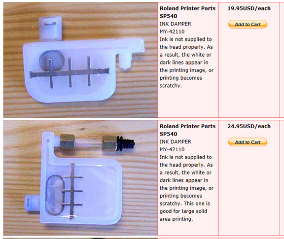

Anyone have a Roland SP-540V and changed out the Dampers?
I'm looking into them and notice there are two different ones, a shallow one and a deeper version good for printing large solids.
Anyone have any thoughts or advice on which one to use?

I was looking at the dampers on my SP-540v, it doesn't look like there is clearance for a taller(Large) damper.
Your printer was designed to use the small ones. If you are having drop out issues it's not because the damper is too small.
