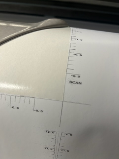

Yes done all the calibrations can get it down to approximately 1mm each way but just can't get it perfect will post pics

I cant really tell from your pic, but both your scan and feed look off. When you print out the test, peel the vinyl off and you can see exactly where the cut line is going in relation to the printed marks
damonCA21
Note as well that the cut should go through the centre of the feed and scan all the way to the top. It looks like your vinyl is shifting as the cut is being made. Replace the encoder strip, and also check your pinch rollers for any signs for cracks in the black plastic parts. It could be worth replacing them anyway as they could be worn and not putting equal pressure onto the vinyl

Replaced encoder strip still having same problems. Not seeing any cracks in the roller mounts but have ordered new ones anyway. Is there a certain sequence to set print an cut?
damonCA21
There isn't really a sequence, you just need to to adjust the feed and scan values until you are getting the cut going exactly where it should be. Note that sometimes this will work by just using the numbers from the test print, but sometimes you need to manually tweak this as well.
What I prefer to do is to make up some artwork with 4 1x1cm squares spaced across the width of the vinyl, with a contour cut around the edge of each. Then run the job and see where the cuts are made, and adjust the numbers based on that instead.
Note that as the numbers can only be adjusted in certain increments, it isn't always possible to get the cut 100% accurate, sometimes you need to set it to the closest you can get it, then use a bleed on all artwork to disguise the slight misalignment. This is more common on older or high use printers where parts have worn slightly, but I have also seen it on pretty new ones where they are just slightly 'out' from the factory
