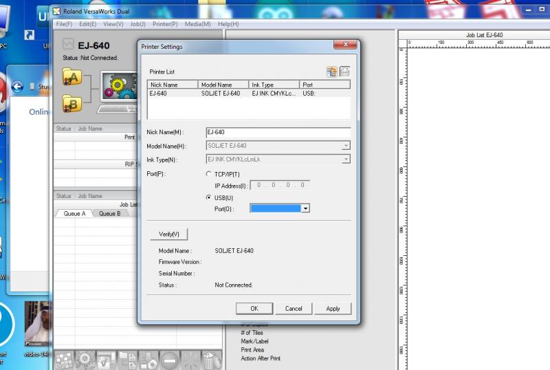

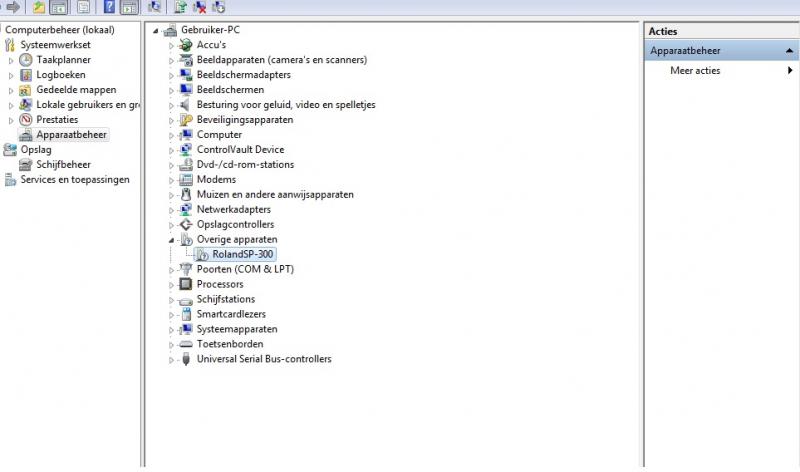

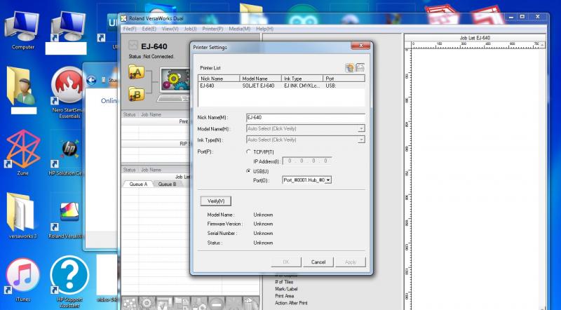

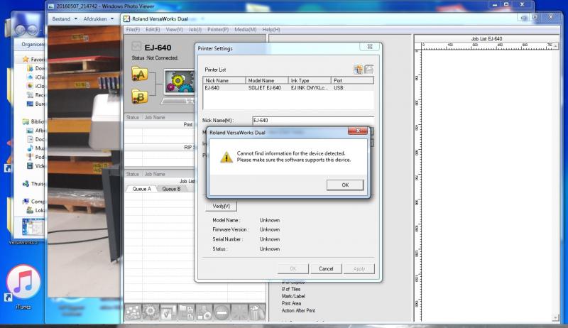

My first experience with Roland. I have experiences in their maintenance. the computer recognizes them. But did not recognize the printing software ,
(cannot find information for device detected please make sure the software supports this device)
look at the pictures

Did you try all of the USB ports? It doesn't find it automatically. You have to try each port until it works. Primitive, I know. Also, Versaworks does not like USB hubs. If you are using one, find a way to connect the printer directly to the computer USB port.
