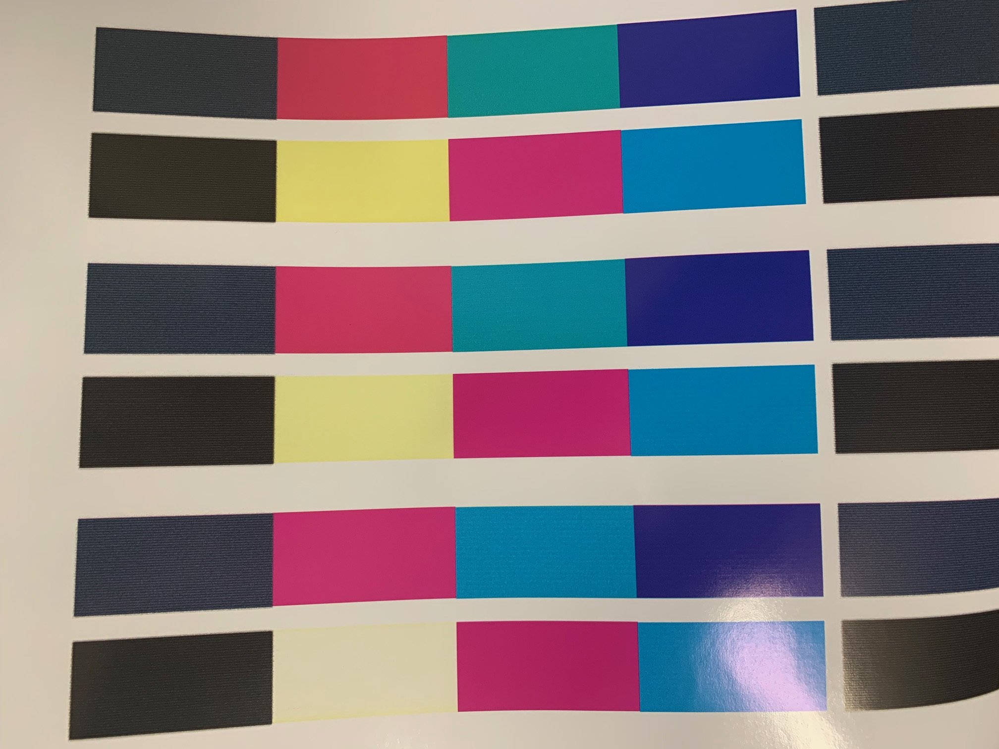

Roland SP300 - Yellow Dropping
James Gallant
Graphic Designer
Did you replace the cap tops? What does the nozzle test look like? Another thing to make sure of is that if there is ink getting to the damper and that you don't have an air leak.
