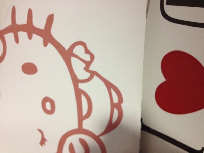

The heart is supposed to be red?
and the hello kitty supposed to be pink?
I've printed both and turned out perfect before now this?
I've tried a cleaning & pulling cartridges out and putting back in also.

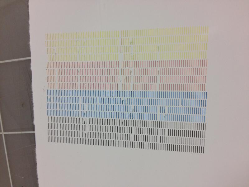

Also seeing drag lines in the black that are probably from something (fuzz, hair, etc) on the bottom of the head.
When was the last time you changed the Wipers, Scraper and/or Mist Sponge? Captops?
Your test print should be the FIRST print done every day. If it is in bad shape, you can not expect quality print results.
CS-SignSupply
Clogged nozzles and contaminated captop/head on magenta/yellow
Interesting how clogged nozzles follow same pattern on 3 of the colors (both heads). Scratched printheads maybe?
Replace captops, wipers and do NORMAL clean. Head soak may work but my guess is that the captops have not been changed in a long while.
What inks are you using?
anotherdog
That looks like a band of crap across the head.
is this print post cleaning?
Some shops have such a high rotation of staff, sometimes the guy doing the printing doesn't know everything about the machine. I have seen some heads caked in ink, not having even basic maintenance in over a year.

I have had this.
You are getting an ink leakage/cross over in the MY head
You almost certainly have a full cartridge of M and an empty(very low) Y
= An ink imbalance of some sort in the head/damper
Short tem solution
Replace the empty (y)cartridge with a new one. Print a block of yellow to run out the contaminated ink ,perhaps (0.5m2 or more.)
Long term solution = probably replace dampers. but I have not done that yet.
It is a bit scary when a job comes out wrong for some colour combinations
eg Y into the M causes dark blues to be dark green
