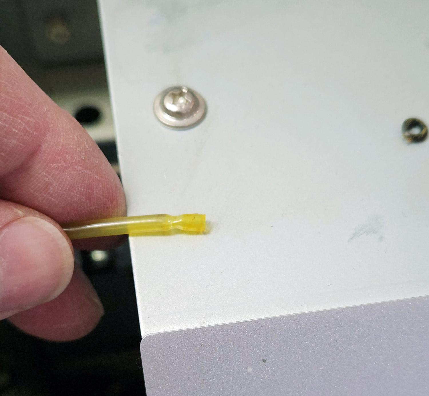

I changed dampers and caps a few weeks ago to address another issue, and the cross contamination started happening. It's mild and only affects the print for the first few inches (the ink is not going all the way back into the lines, and I can't even see discoloration in the dampers). I checked the pump and drain lines and they are all clear. When I changed the dampers all of the ink lines had kinks in them (picture attached), so I cut a small bit off. The problem I think I'm having is the damper o-rings... I didn't have new o-rings so I used the old ones with the new dampers. It started with the magenta contaminating the yellow and after much testing and even changing the yellow damper again, I thought I'd try swapping out the yellow ink (as it had less left in it compared to magenta). Once I put new yellow ink in, the cross contamination started going the other way with yellow into magenta (which makes sense I suppose as the system seems to be trying to equalize and now the magenta is lower).

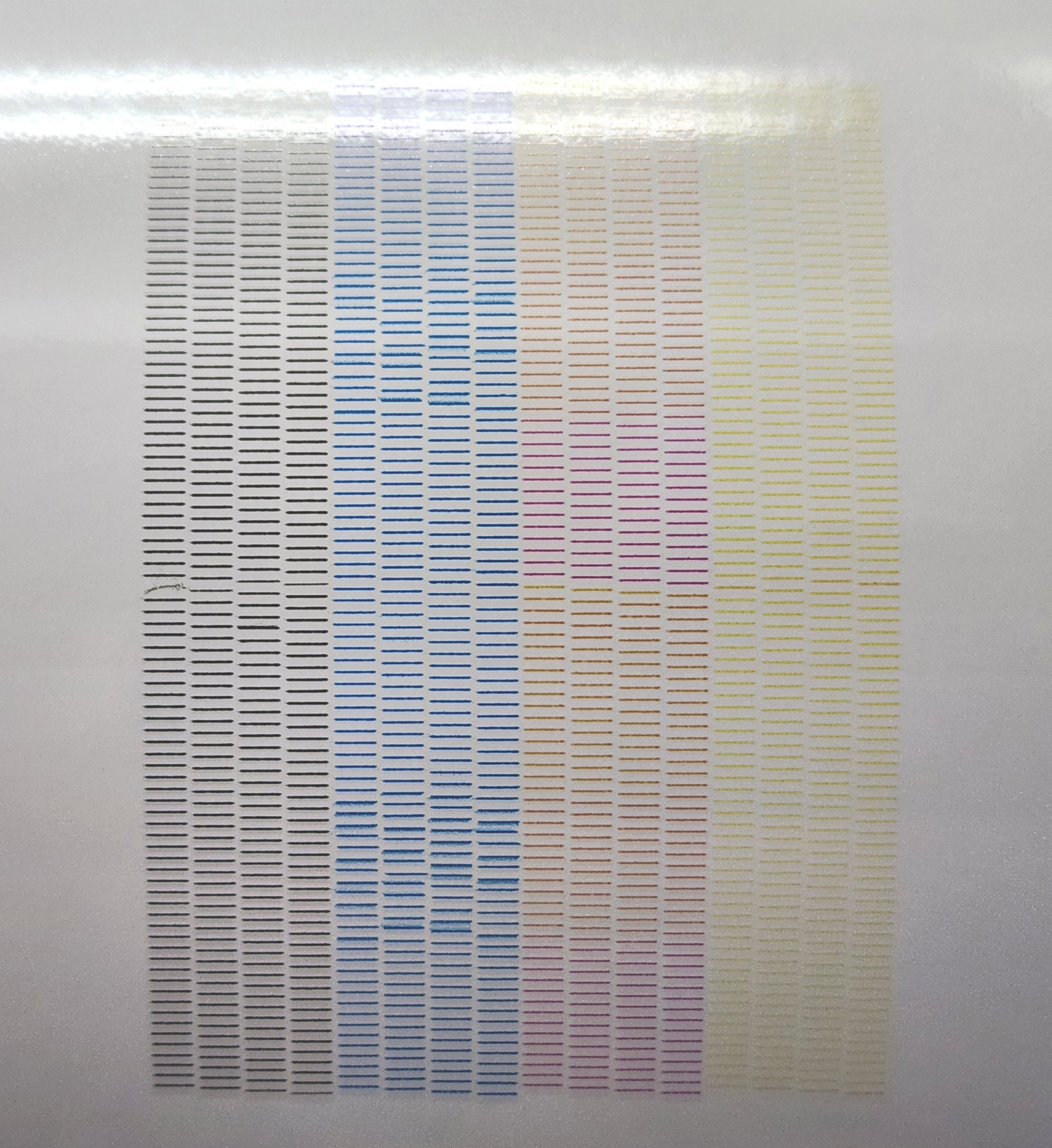

Hi. I hope your o-rings worked. I am wondering if you or someone else following this thread can help me. I have an old SP 300V, but its very new to me. I am just learning, I have run a few successful sticker jobs, but my magenta has dropped out almost completely (very few lines on the test print) I also noticed some contamination into the yellow. I have run cleaning, normal and powerful, and then did a manual cleaning (there was quite a bit of build-up) and had poor results(pretty much the same) so I did a head soak overnight. No change to the the magenta strip in the test print, but the yellow is now very contaminated and pretty much orange. I don't even know where to start, any advice would be appreciated.
