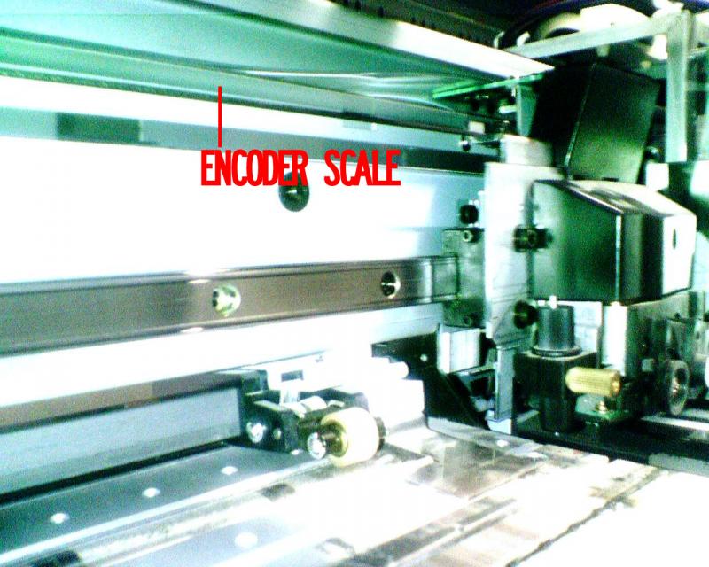

Clean the encoder strip front and back using a clean, dry lint free cloth. Have you noticed any print quality issues?

Cleaned the encoder strip front and back and that worked for a while. Thanks. Eventually called a rep and had a new encoder strip installed. Everything is back to being great!
