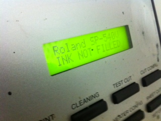

My buddy has a Roland SP540V and it is stuck in "INK NOT FILLED" menu .
every-time I power on it keeps saying this. I've unplugged and let sit for 10 min and still keeps wanting to feed all the ink from the cartridges does anyone know how to get around this and save my ink?
I've attached a picture as well
Thanks.

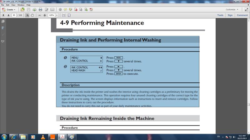

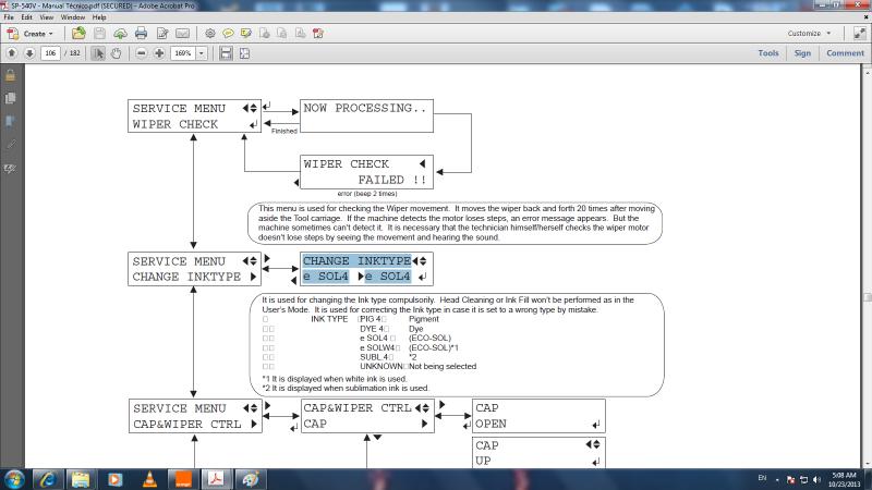

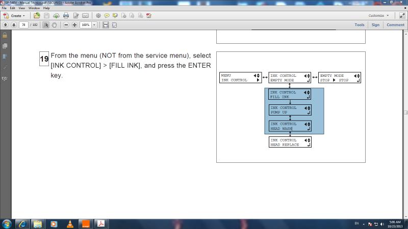

Mybe you get in (ink control) from menu and press (head wash) untitled1 , try by bottom up down to find canceling for this procedure If the user menu hanging can't get in try the service menu> (ink control>head wash) ,I don't no if that help just try .When you get in service menu detect that ink type e SOL4 no changing untitled2, nothing work there is a command from service menu (ink control>fill ink) untitled3 .Finally to pass this error mybe you need to complete the procedure by insert cleaning cartridge follow the description in untitled1.
